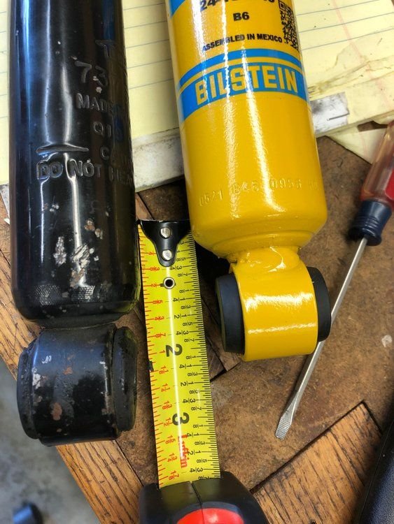

My experience rear b6 here
https://www.corvetteforum.com/forums...s-install.html
i found the b6 to be shorter than the replacement ac delco (which sucked) and when rear suspended , is the stop for droop where the ac delco would allow more travel.
