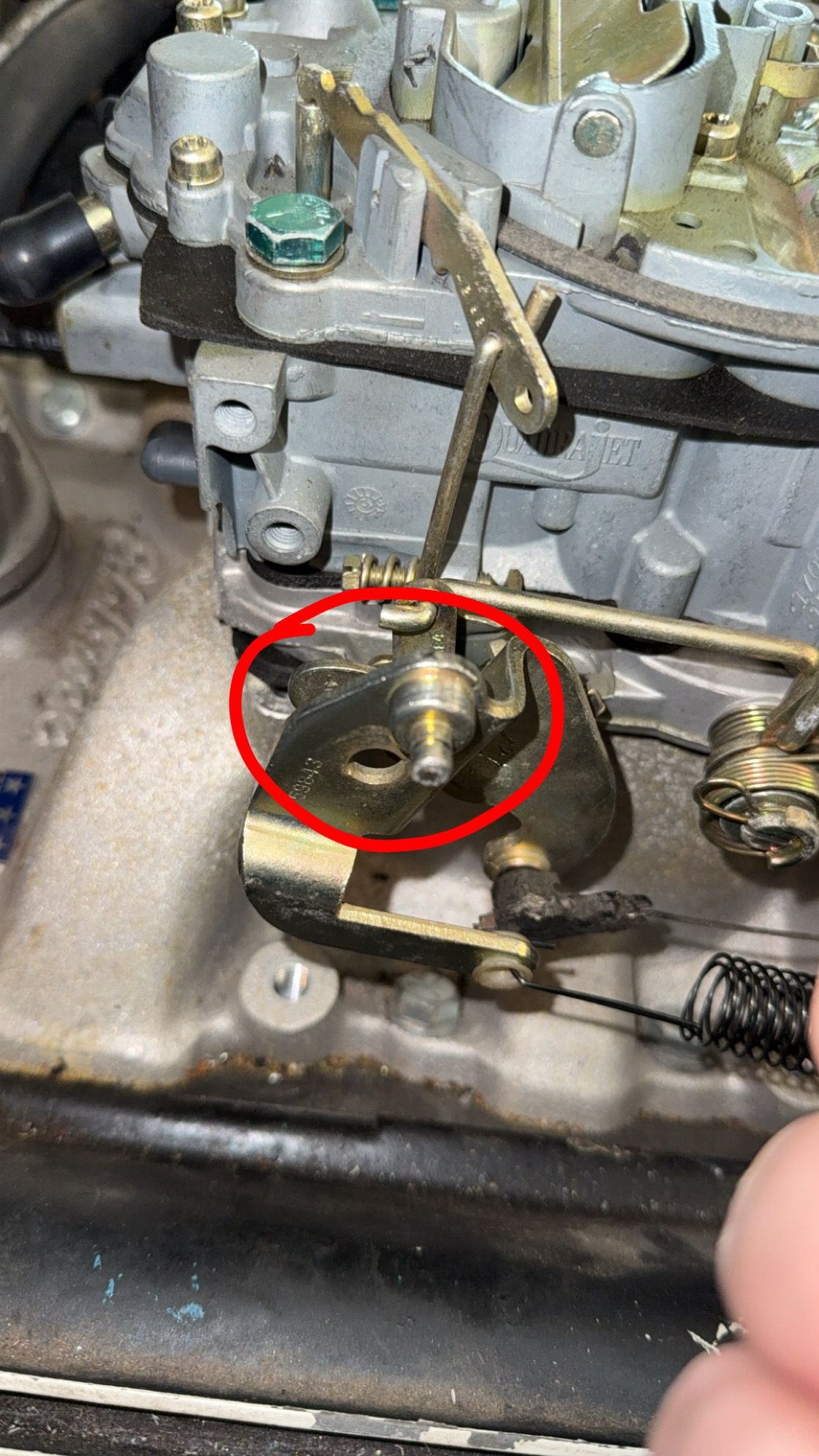

Hey everyone I just picked up a 1982 c3 that has a quadrajet on it. The problem is I’m not getting full travel in the linkage and can’t seem to figure out why. The throttle cable appears to be a factory style c3 cable. Any input or tips would be appreciated. Thanks

The linkage ball stud needs to be in the lower hole for corvettes, not the upper as current.

To get more travel on my carb I removed the gas pedal assembly and bent it so it sits farther away from the floor.

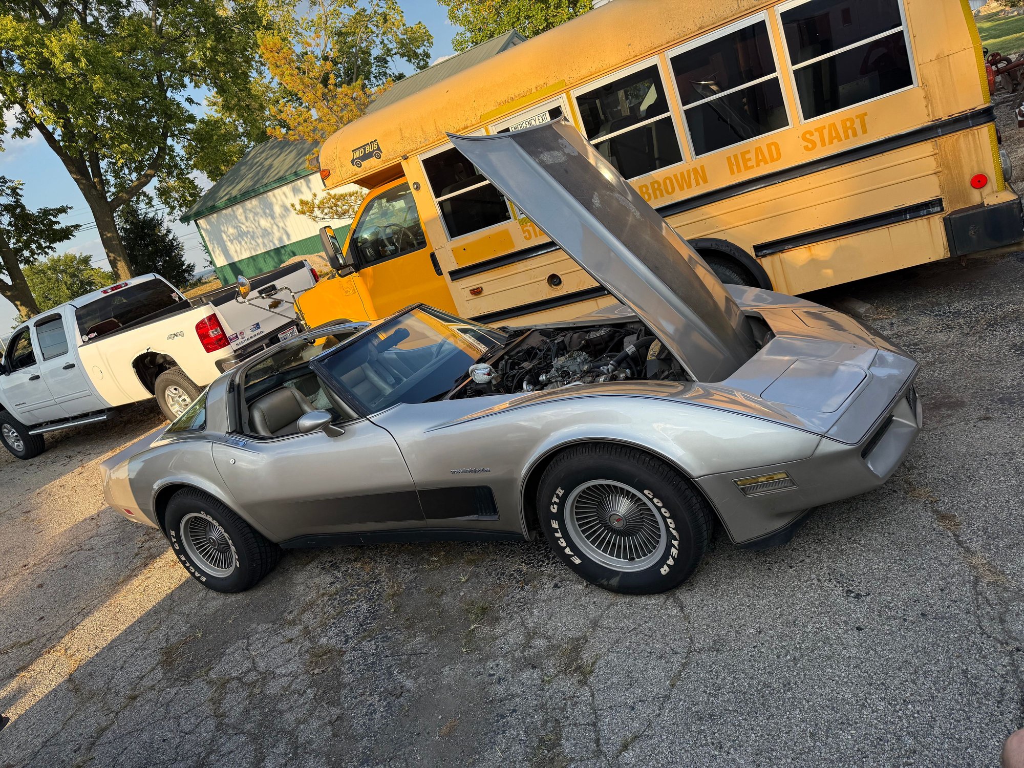

First, as noted above, the '82 Vette never came with a carb. It was a CrossFire Injection engine. The carb that has been scabbed onto your car is a hacked, commercially rebuilt mid-'70's truck carb that is best suited for you to practice your hook shots into the garage trash can. The throttle cable attach stud has been installed in the wrong hole in the throttle lever, so you cannot achieve full throttle actuation. It is also highly likely that you do not have enough accelerator pedal travel to pull the carb throttle all the way open, so you need to take a look at your accelerator pedal linkage and bend it into position to provide adequate pedal travel. This will also likely involve removing your floor mat and removing excessive padding under the carpeting in the accel pedal area.
...But you have much bigger problems than not achieving WOT on that carb. You do not have the correct CC distributor, so you have a real mess of a job for ignition - obviously, your computer has been disconnected. They have installed a vacuum advance distributor, which is not correct for your car, and I can see that the vacuum advance is disconnected, which means you have significant timing problems. You need to do a complete evaluation of your configuration and get that thing straightened out - you have a real messed up engine configuration. It's a total hack-job. Did you know what you were buying when you bought it..? If you are not aware of these issues, I have a funny feeling you did not do your buyer-beware research and just got hosed... the '82 Vette is a 1-year-only highly unique configuration car, and there are very few people in the U.S. who can work on them - therefore, most of the '82 Vettes are hacked, badly modified cars that you don't want to touch unless you are very skilled at working on them.
How do I know? I bought an '82 25 years ago, and I spent the next year of my life becoming a self-learned '82 Vette mechanic to get the car into good, drivable condition and un-doing all the hack-work done - just like on your car. If you're a really good mechanic, you have a long journey based on the few photos you have provided...

The car is an 82 collectors edition, it was a barn find out of Georgia. The guy I bought it from switched it over to carb before I bought it and didn’t work out all the small issues. I have all the original parts stored. The throttle cable attach stud is pressed and riveted in so I can’t move it. Even if I’m able to move it to the lower hole it still doesn’t seem like it would have enough travel. Is bending the gas pedal a typical solution on these cars?
Yes....the pedal arms flex and bend and floor mats, carpet, insulation reduce travel even more. Pretty common to have to bend them up under the dash.
You may have to grind/drill the stud out to get enough travel.

It's very common to have to re-bend the accel pedal hard-linkage under the dash.
You have to grind off the swage on the back of the ball stud installed in the wrong hole (you have a truck carb, so it has the ball in the truck linkage position) and remove it. Buy a new screw-on ball and install it in the correct hole.
