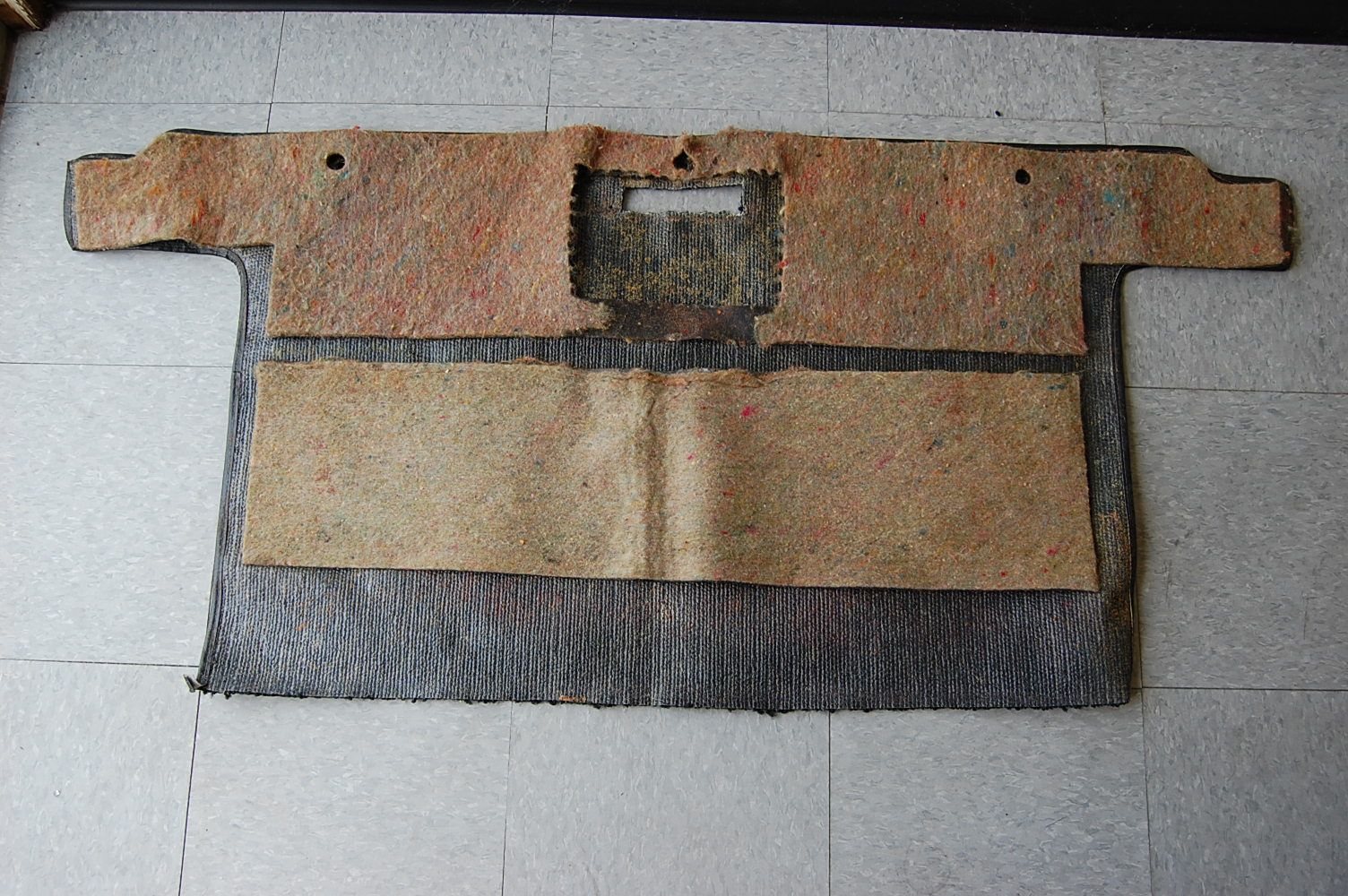

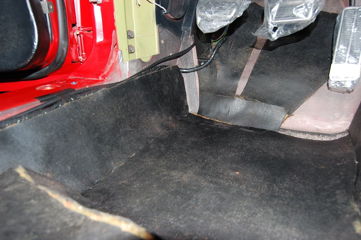

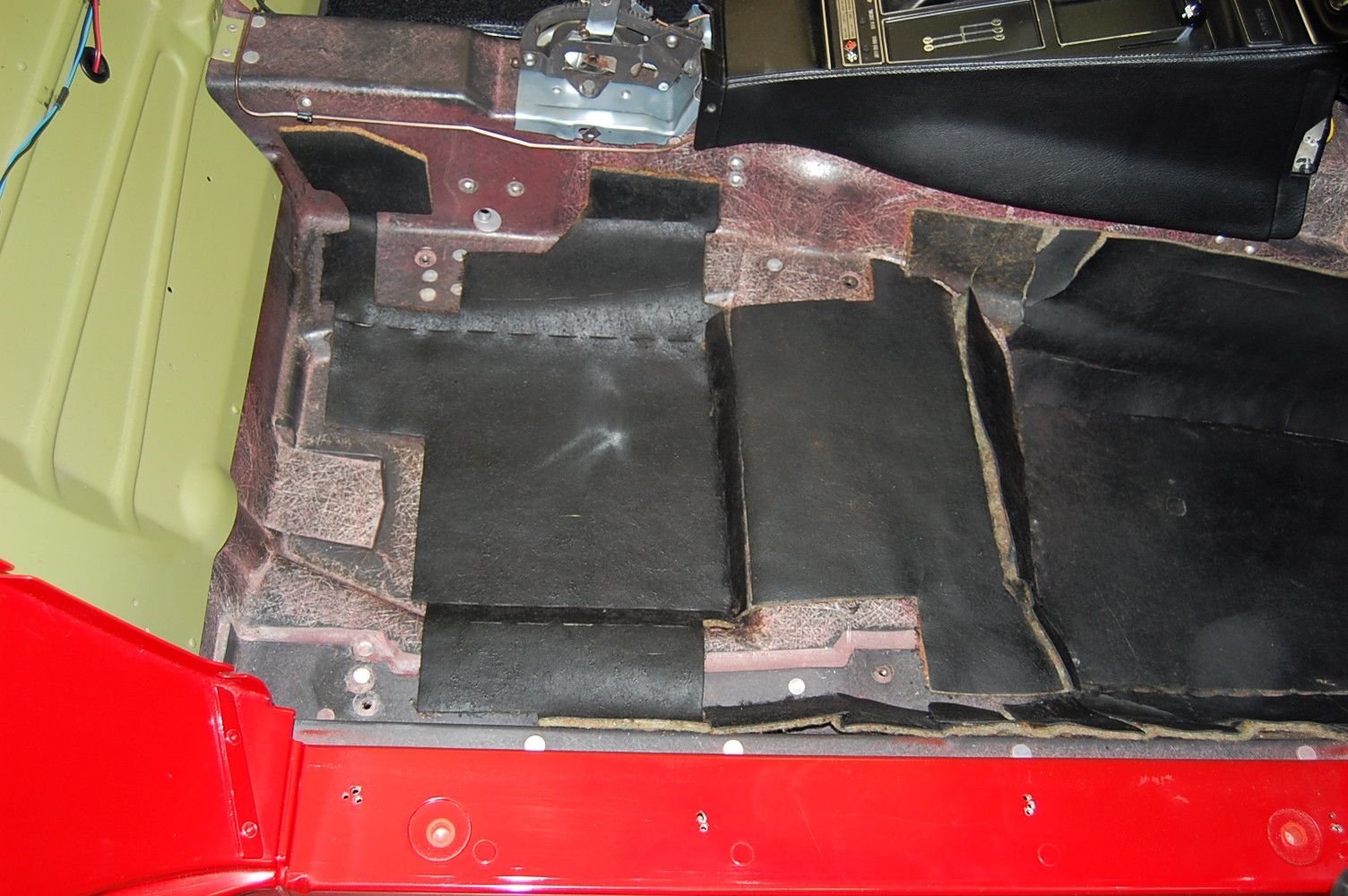

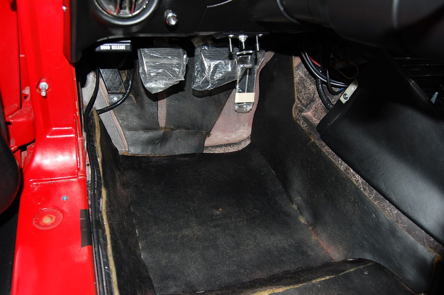

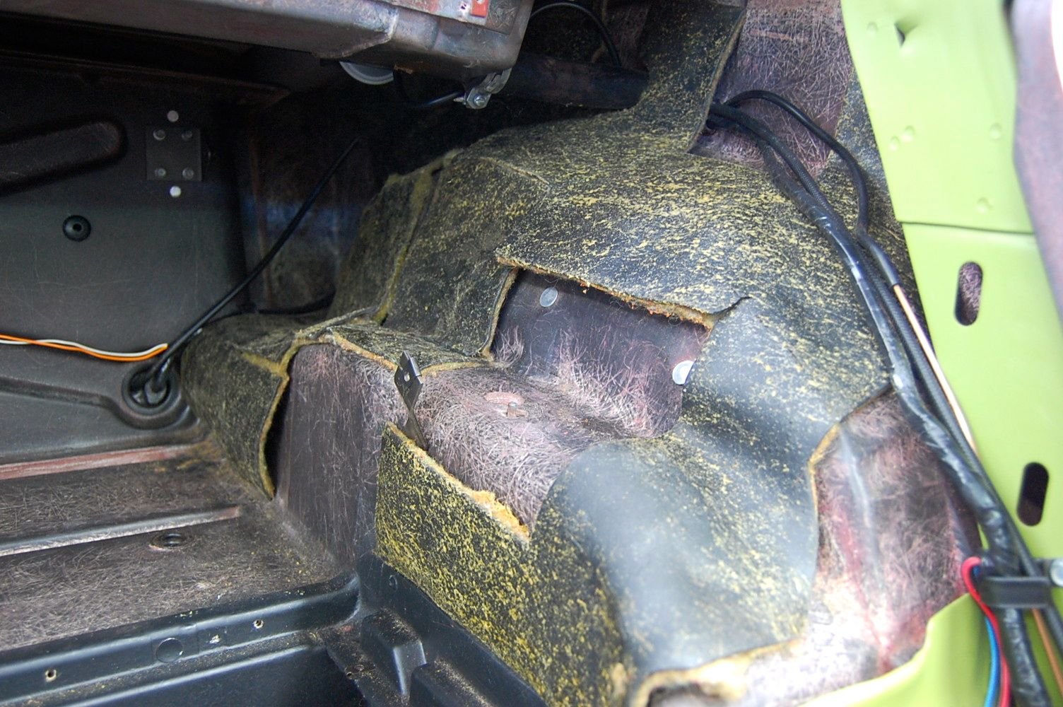

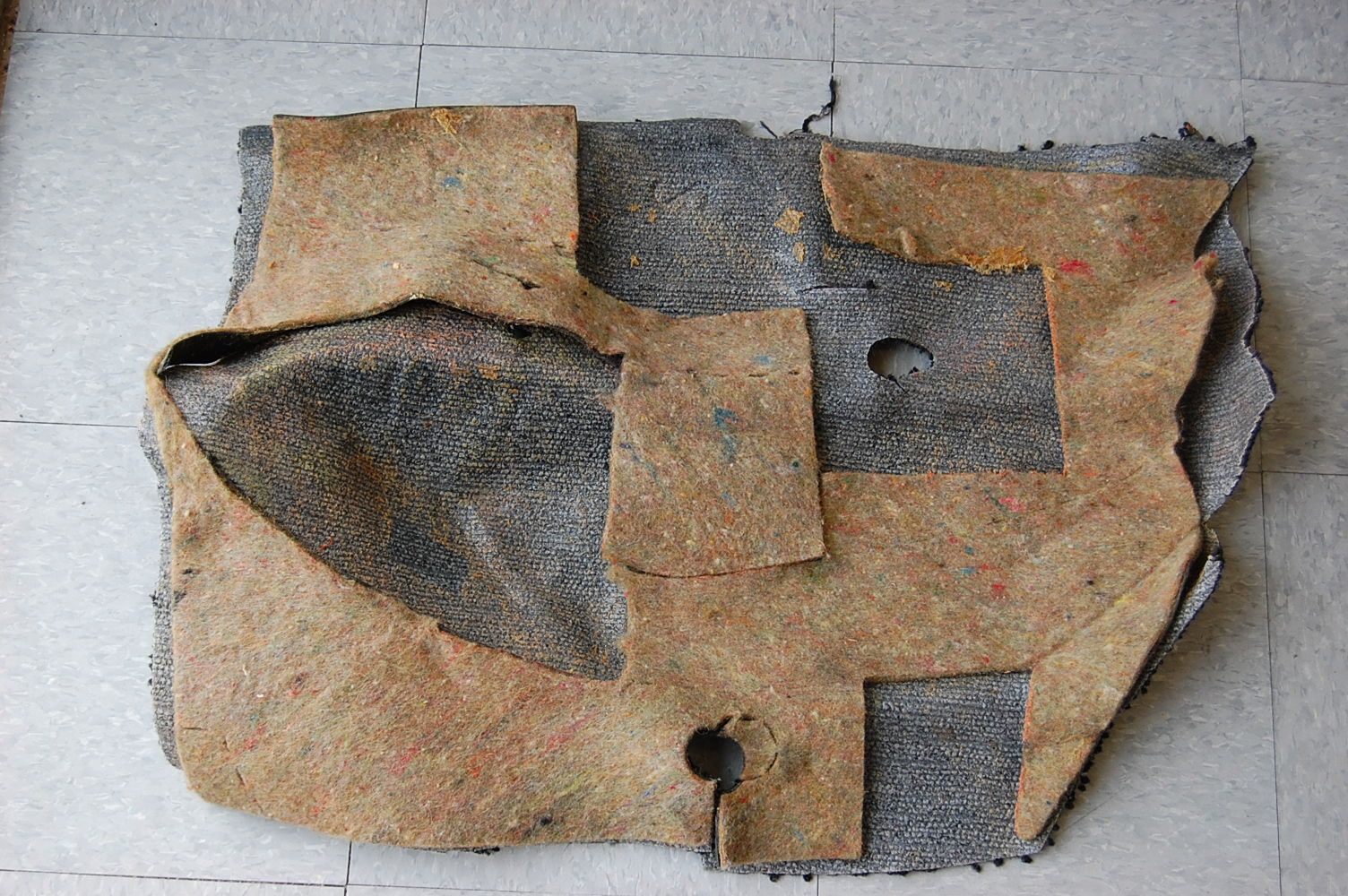

Hello,
Remember the cars we love are close to or slightly over 50 years old.
Chevrolet did install underlayment to help control interior heat, moisture and sound.
But not like anything like the materials available today.
I'm not sure how the fact that the body was fiberglass may have impacted these 3 issues.

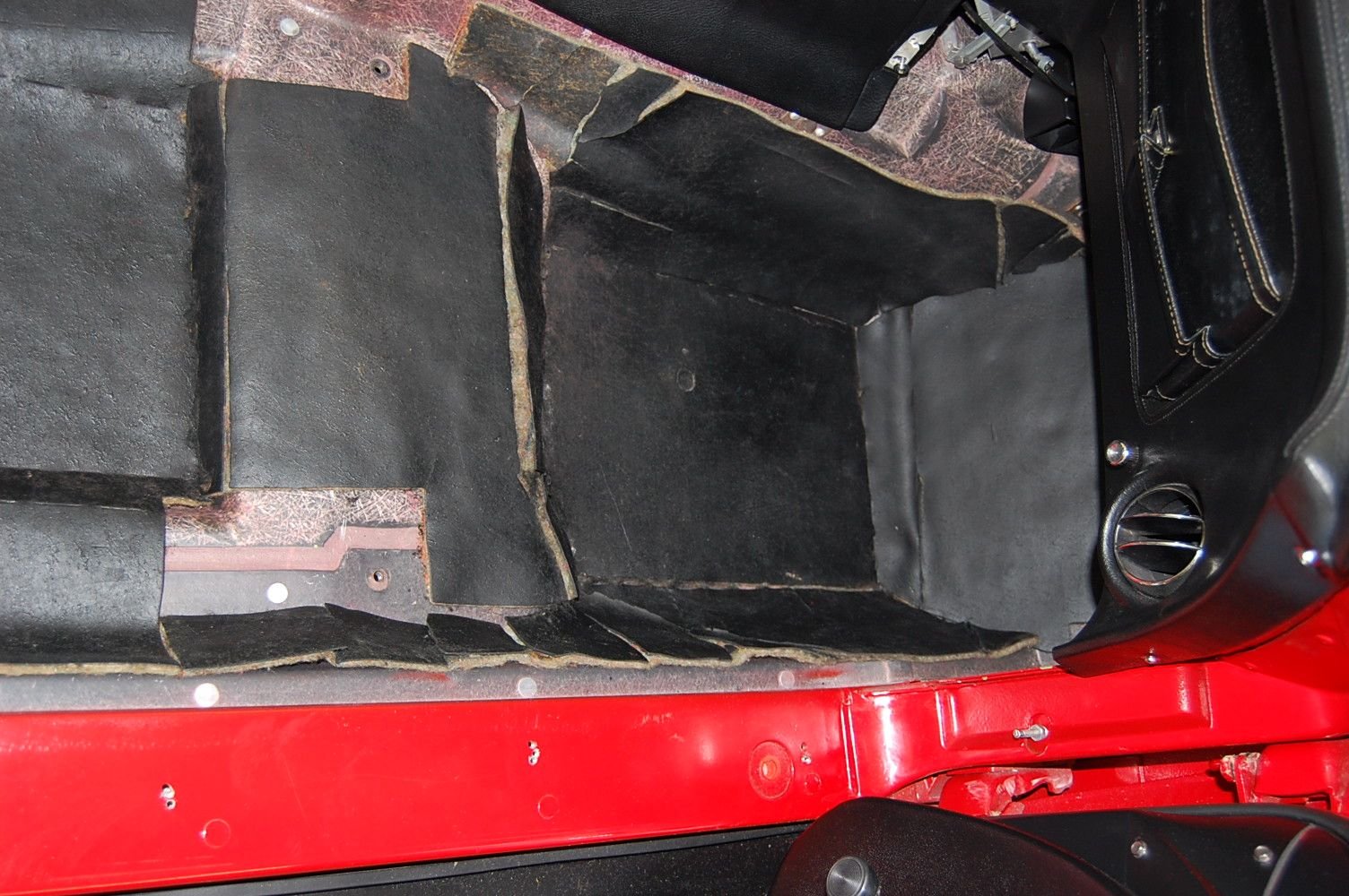

A few photos of the original underlayment from a 71 coupe.
Jute and rubber.
Regards.....
Rear bulkhead
Rear Wheel well
Driver's side wheel well.
Passenger's side compartment
Passengers side foot well
Drivers side foot well
Drivers side floor
