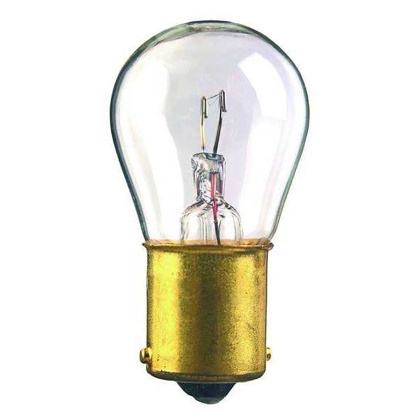

Yes, What year? Backup lamps should only have one filament in it. It is an 1156 bulb. 1156 and 1157 (two filament bulb for running light and brake light) cannot be interchanged as the little post on the lamp are staggered on the 1157. And backup lights will only have one wire going to it as on all the tail lights the housing is the ground (with a wire to the frame of course).
1157:
1156

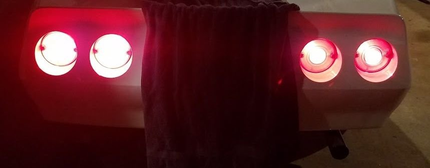

I modified mine to do that, then added separate LEDs below the bumper for the reverse lights. Do pairs of lights light when using the turn signals, or only the outside?
Here's what I did (left turn signal activated, with running lights on the right, and LED bulbs).
Can you get some photos from under the bumper? Either a PO spliced something in at the rear, or in the cabin.
Originally Posted by Bikespace
Right now, the bulbs are wired in the 1968 manner, with both pairs operating together, giving 4 bright brake lights, and two turn signal lights (left turn signal is activated in the photo below).
