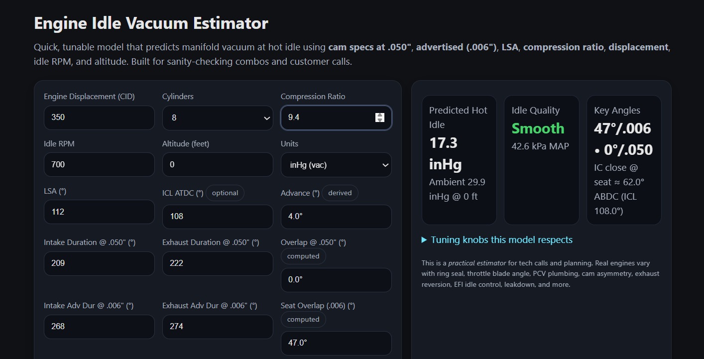

When it comes to cam specs, you will get 100s of recommendarions, from 100s of supposed "experts".
But consider the source, and their experience.
Jones Cams is very likely the single most revered cam expert in the US.
Using Jones full cam specs, I got a 17.3" vacuum even at a very low 700rpm idle. Very easy to live with.
The 6* difference in the intake duration between the 2 cams listed, should have very little noticeable difference.
If it were me, I would use the more modern GM grind they use in the crate motor. GM knows a thing or two...
