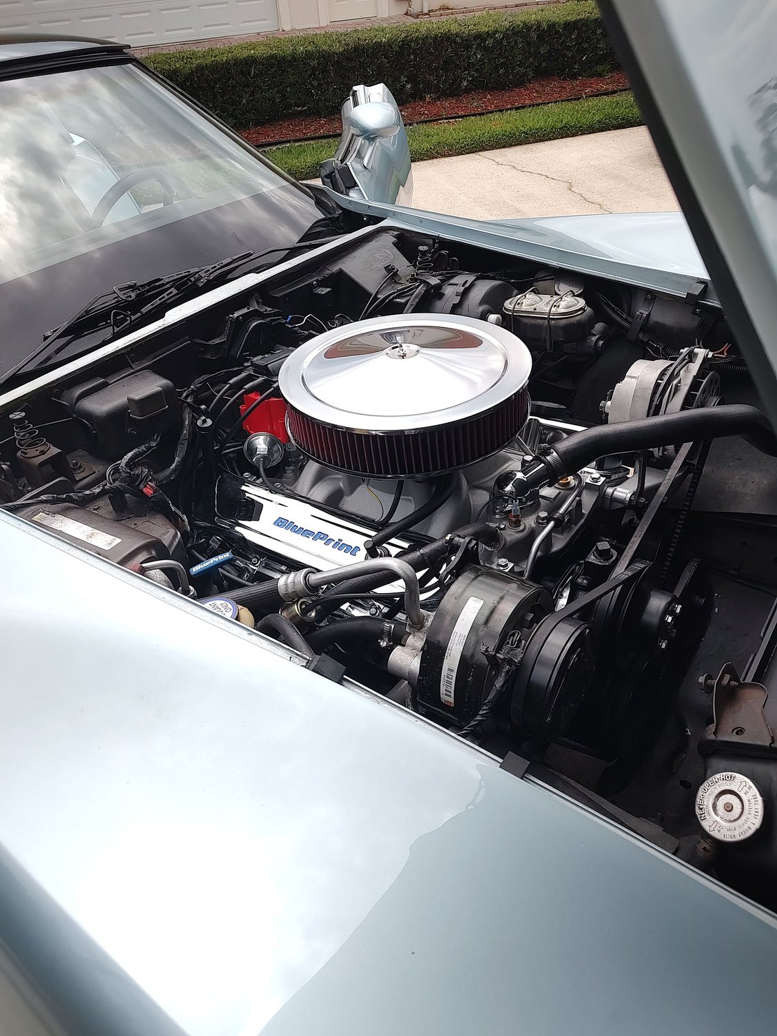

JT, you're killing me! LoL. It's time to order the Blueprint 350/341HP, a Blueprint flex plate and harmonic balancer from Summit. Forgot about the PG260 starter. Get the 9100 Powermaster starter. ACDELCO 252585 Water Pump. Trust me 😉.
