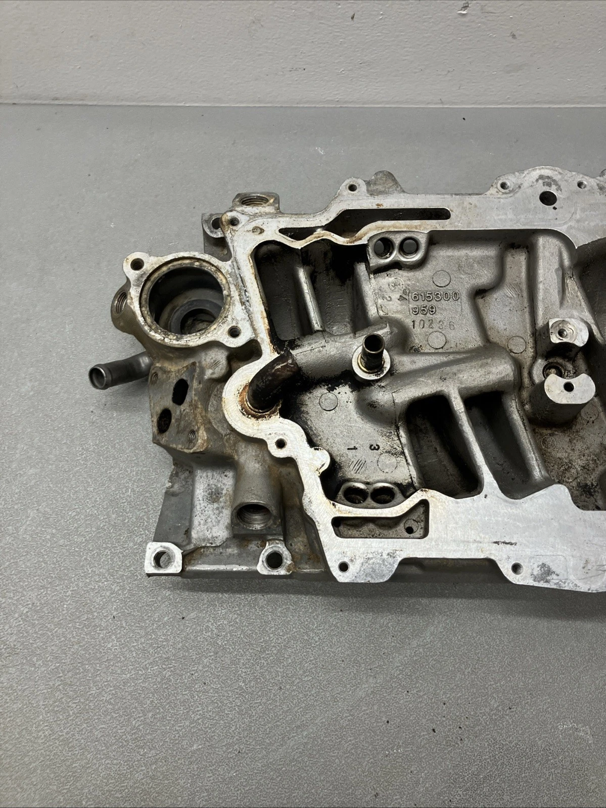

In OE L31, the OE lower intake actually has 'seat' cast into lower intake, immediately below t'stat. The OE L31 t'stat has an integral disc that fit's that 'seat'--- unlike any BBC or earlier sbc. On OE L31, that 'seat' is ported to top of OE L31 water pump.
Rather familiar w/ L31 and its variants; I've yet to recognize an aftermarket intake that actually has a 'seat' for disc t'stat cast-in.to those Non-OE intakes. Seen (and handled) dozens & dozens & dozens of x602 race crates. Don't recall anyone running an L31 bypass hose. That disc t'stat is very common, but it's a different animal than prior sbc t'stats. Me thinks later Gen III LS platforms utilize same t'stat but mounted to water pump and 'sideways' to boot.
Yes, I know the GM/Chev Performance Vortec intake do have a coolant port for elbow; but do not recall those intakes having any 'seat' for a disc t'stat.
A poor pic grabbed from fleabay, but you cn resolve the seat in bottom of t'stat housing hole.
Vortec Intake Lower 5.7L 350 5.0L 305 96-00 Chevy/GMC SUV  Pickup - Picture 3 of 4
