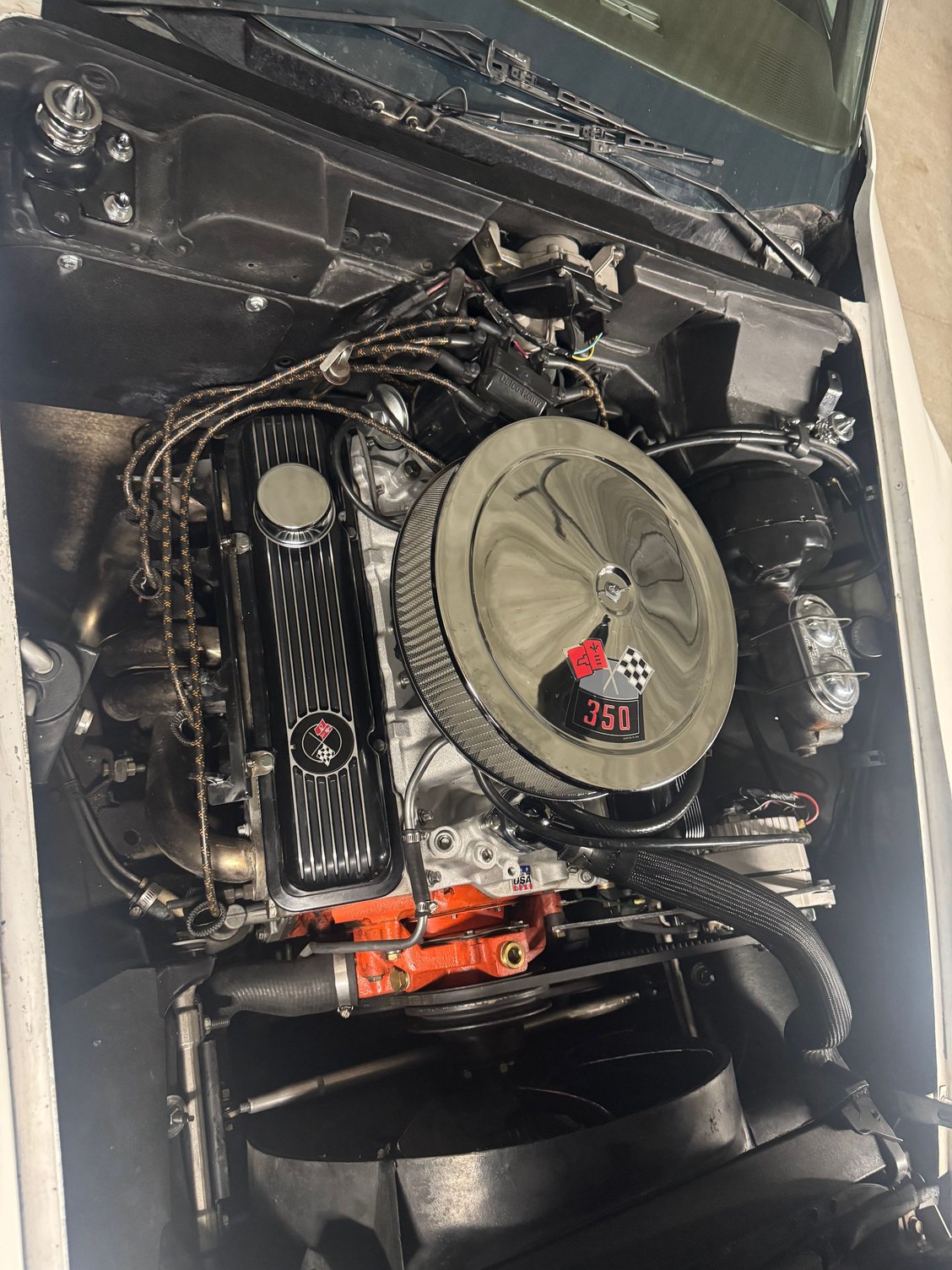

My 1973 L82 has been diagnosed with a blown head gasket. It is currently stock with about 42,000 original miles. So my son and I are considering doing a top end replacement like this one from Edelbrock:
https://www.summitracing.com/parts/e...gaAs9YEALw_wcB
Has anyone had any experience with this Edelbrock Total Power Package 338 HP Small Block Chevy Top End Engine Kit. It looks to be a complete and cost effective head, cam, intake, and timing chain kit. Seems to be fairly straightforward to install. Any comment or advise is appreciated.

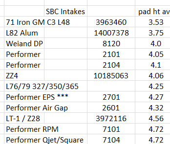

73 hood is about the same height as a 72 LT-1 hood. So an LT-1 intake would fit, but it fits square bore carb. They have maybe 1/2" to spare.
Eddy 7104 MIGHT fit, but Eddy 2601 would be safer.

Can confirm the 2601 fits and is a great upgrade.
