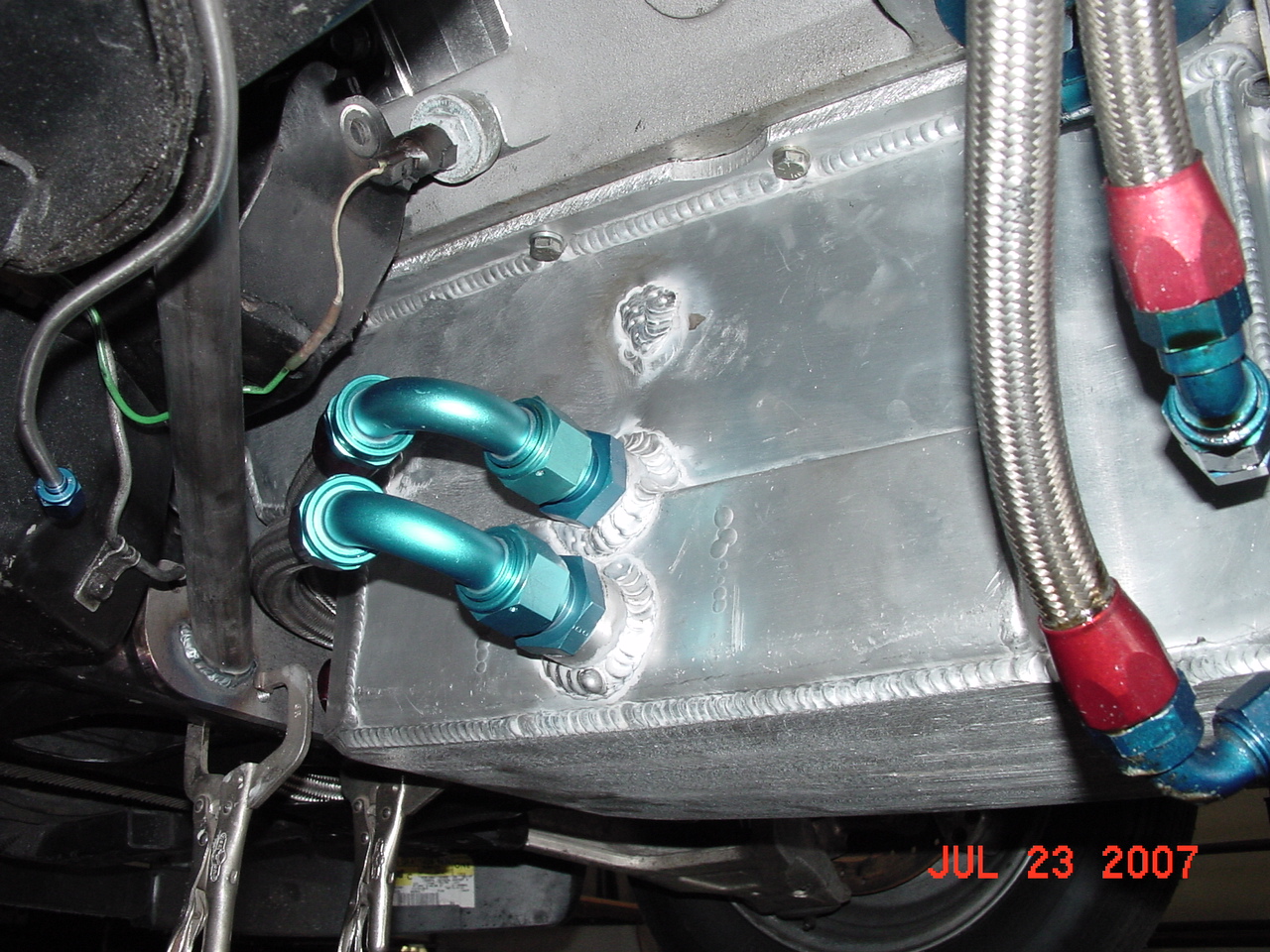

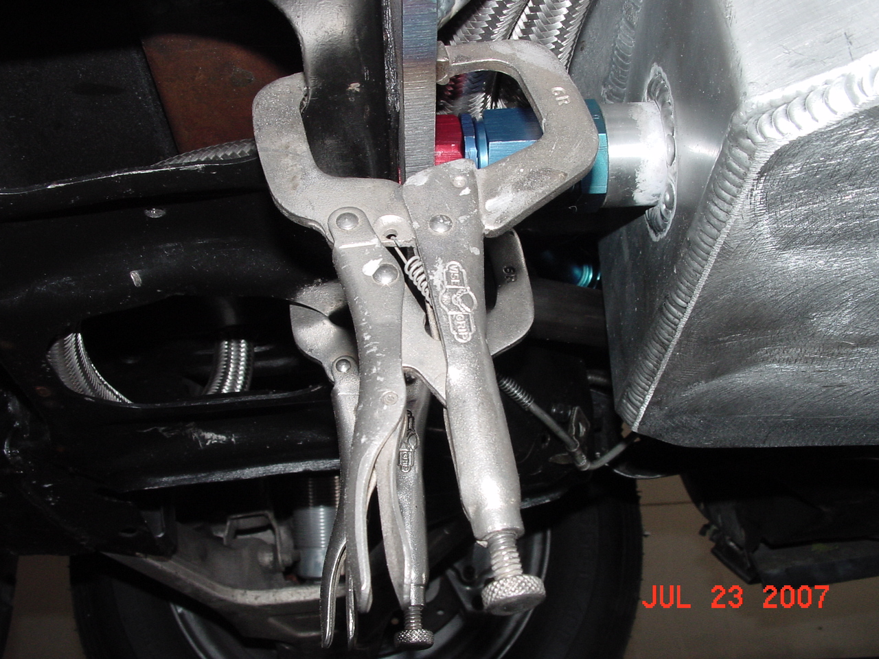

Started the 5 stage dry sump install.
PICS:
http://www.3cinc.net/images/drysump1.JPG
http://www.3cinc.net/images/drysump2.JPG
http://www.3cinc.net/images/drysump3.JPG
http://www.3cinc.net/images/drysump4.JPG
http://www.3cinc.net/images/drysump5.JPG
http://www.3cinc.net/images/drysump6.JPG
