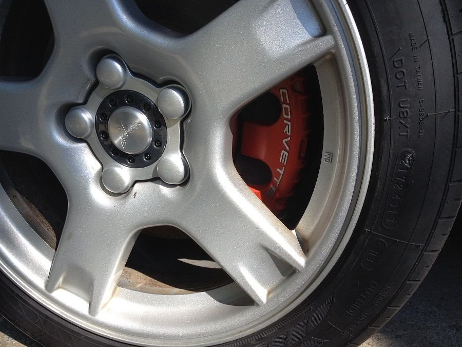

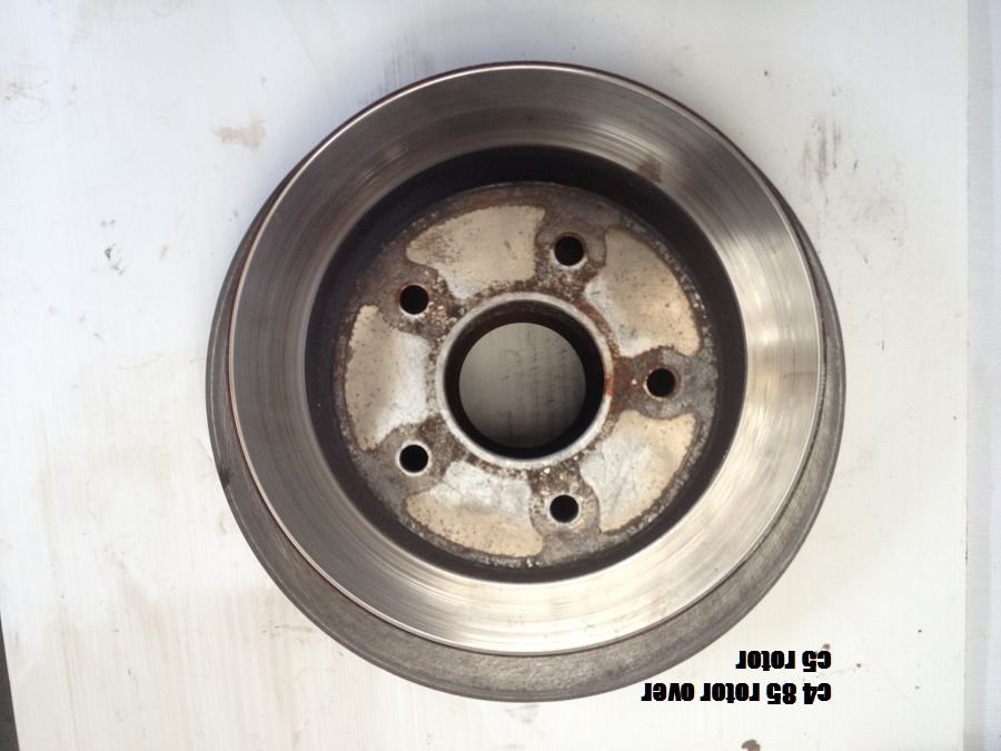

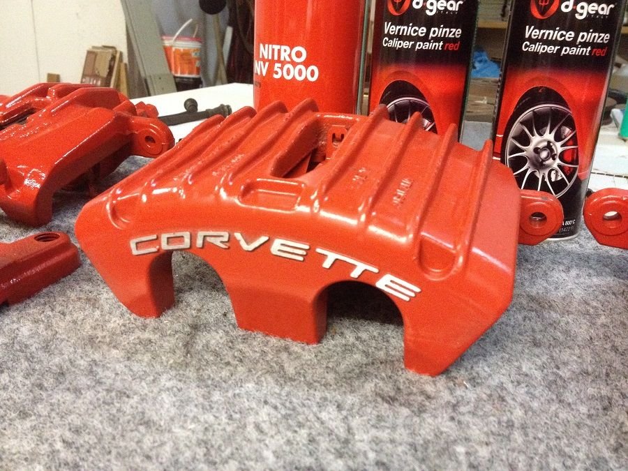

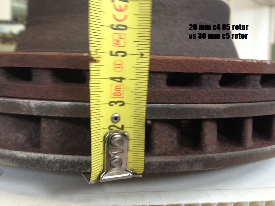

A common upgrade to the stock brake system (i have an 85 too)is a C5 calipers 2 pistons.But ,as you know you need 17"rims and even the sawblade 17 don't fit .Usually the A-mold 17 are the choice for a C5 calipers upgrade.Since you have non stock rims,as said, you have to trial and error the fitment. i bought a set of 4 x 18" rims (4 rear C5 "wagon" that lot of guys here said look very cool an an old c4),i used 2 adapters...done ,huge improvement for a cheap price.

I did a front C5 conversion some years ago on my '87. IIRC, I paid about $700 at the time just for the C5 brake components and another $100 for adapter brackets. I used AFS Wheels ZR-1 style wheels in 17x9.5" with the correct 38mm offset for the 84-87 cars. Because the car is used primarily for autocross and track days, I thought that a brake conversion would be worth the time and money.
I found that it really was worth it for what I use the car for, but for general street driving, the OEM brakes will work fine. Good performance pads, a quality DOT3 or 4 fluid, new stainless flexible brake hoses and good rotors will provide very good braking performance. I also believe that there is no huge improvement in braking with drilled/slotted rotors for general street use.
If you are intent on a C5 front brake conversion, note that the special adapter bracket is slightly different for the 84'87 cars compared to the 88 and later. Make sure you get the right ones. For the C5 caliper, there is no difference between a stock C5 caliper and a Z06 caliper other than paint color. Same with rotors. Same diameter, same width. I've been using stock Z06 pads and they work well for my car. Again, there are lots of good aftermarket pads depending on the use of the car.

I have the Enkei Z51 wheels and they did clear for a while. Then the pins got worn and the calipers started moving around and scraping on the inside of the wheels. I was filing off the cooling ridges to get more clearance but that was a temporary solution that didn't last. I finally went to 17" A-mold replicas with the older offset to fix the problem for good.
