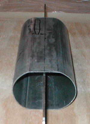

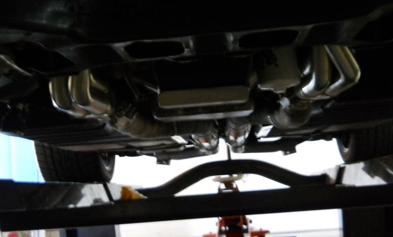

I had the same problem in Massachusetts until they stopped emission testing pre OBD2 cars.
I have a supercharged ZZ4 crate engine and with a stock type Dynomax exhaust I measured over 15 psi of backpressure at the right oxygen sensor fitting, full throttle before shifts.
After a long discussion at a referee test station, he said yes to Carb EQ headers and he didn't care much about the rest of the exhaust, but the converter had to be stock (or legal stock replacement) and in the stock location.
Put on headers and fabricated two 3 inch pipes. Took a 6 inch pipe and walked it thru my shop press with a 3 inch square die inside to make an oval pipe. Removed the heat shield and cut the converter front and back to match the oval pipe and reinstalled the shield. Ran that oval pipe back to mate up to the stock type y-pipe and Dynomax mufflers. Measured about 6 psi of back pressure at the collector, at the shifts with this and passed emissions for about ten+ years. The converter was still to restrictive but the pipes helped a lot.
Now I have dual 3 inch bullet converters and dual 3 inch exhausts back to 2.5 inch Magnaflow mufflers, and barely register 1 psi at full throttle shifts.

Outside the box thinking, dig it. Theres always a way!
