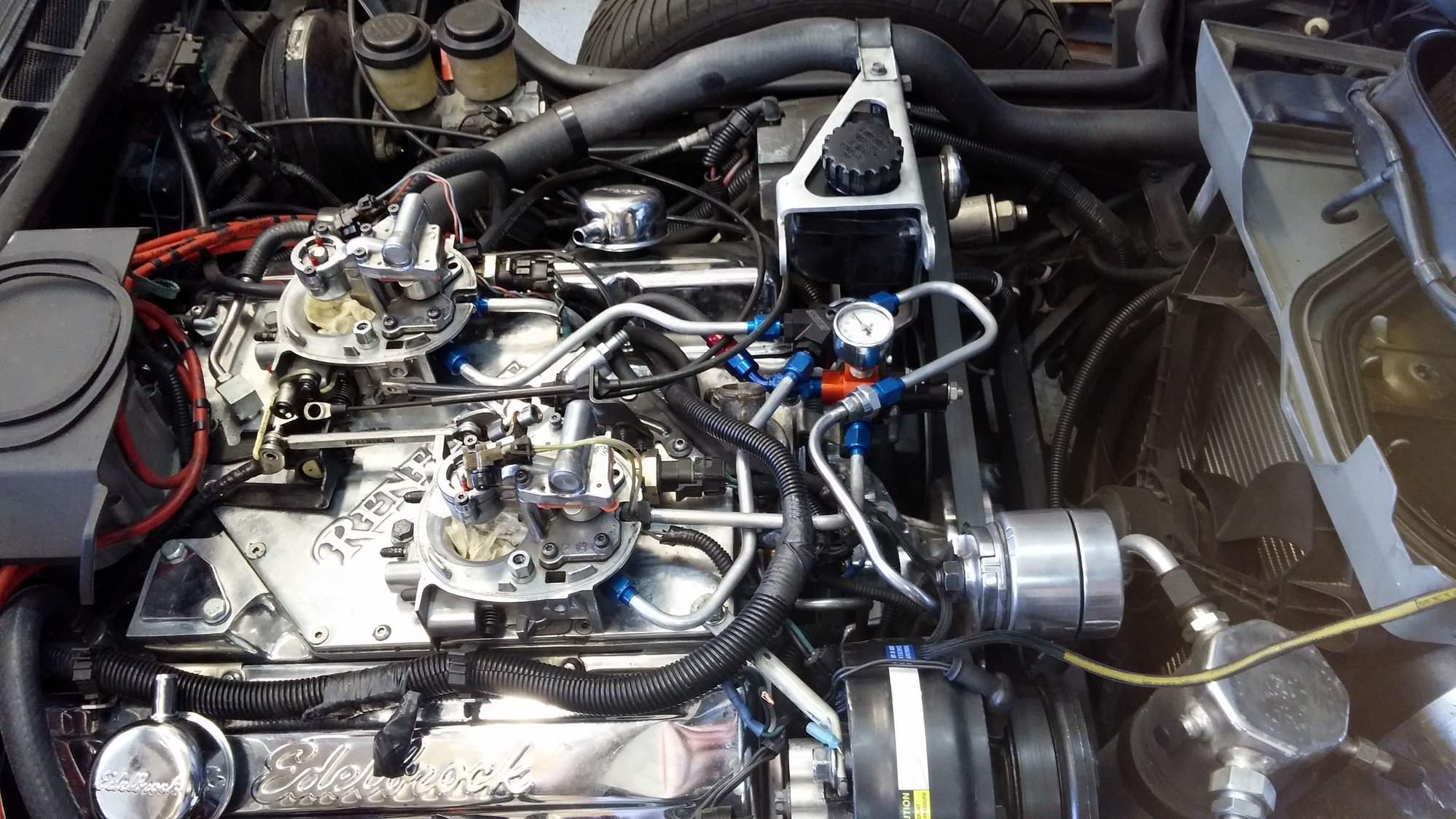

Originally Posted by Gibbles
Take a good look at the intake runners where the egr goes underneath.
Mine had some serious casting flaws that i needed to clean up.
(Too much metal, and a ridge inside of the runner)
I also bought the polished version, i have been suspecting that the polishing was to salvage a bad casting.
Easy fix, and i opened the runners a tiny bit more while i was in there.
Also the polished version looks great, but it's nearly impossible to keep looking pretty with how often i drive the car.

Looks pretty neat, but the fuel line going over the belt is a little worrisome. If that belt were to fly off or break, it could end up to be bad news in a hurry with a hot motor. It may be a picture perspective thing, but it does look like it is sticking way over that belt. Can you take a dead straight across pic? I guess I should probably already know this, but what motor is that and TBs?

L83 with dual cfi tb.
The image looks worse than it is, mostly it was about where the fuel line is vs where the spark is..
I do have some space, but it is over the belt.
Those 84 CFIs look quite a bit different than the 82s don't they?
I can’t work out where to top radiator hose goes. My thermostat housing is at the front like most SBCs.
Old Jul 5, 2019 | 08:11 PM
  #66
84 4+3's Avatar
84 4+3
Joined: Aug 2017
Posts: 6,940
Likes: 1,490
From: New Jersey
Thermostat housing is behind the regulator. His hose is disconnected.
