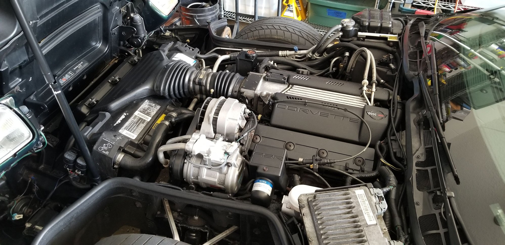

Been following this thread. Car is '94 C4 Convertible with 75K miles.This past Friday my original AC compressor started "growling"...system blowing hot air. I shut the system down, opened the hood with engine running and noticed rubber shavings on top of the clutch assembly...probably from the belt. I then tuned the system back on...intermittent turning of clutch and compressor...belt slipping a bit. I shut everything down and turned off AC. Restarted and it freewheels ok.
My AC compressor/Clutch appears to be the original so I figured after 26 years...hey it's due. I shopped a bit and found two AC Delco OEM New Compressor and Clutch assemblies along with a new dryer for $540 ea to my door. I ordered one. I will pick up an orifice tube and a new belt locally. Luckily here in Ocala I have found an independent shop that specializes in Muscle Cars, and older cars foreign and domestic. These guys are good and have done work for me before. When the parts arrive I will take it to them and let them evacuate, flush, replace and recharge.
I could have gone with a re-man compressor for about half...but I hate paying for the same real estate twice !!
Stay tuned.

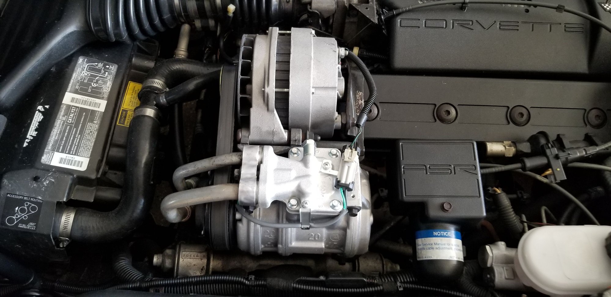

Ok...bought a new OEM Compressor/Clutch/Dryer/Orifice Tube online for $540. Had my local Hi Performance shop change it out...evacuate and recharge for $344 out the door. So I'm all in for $884.00 while I was in Key West on a consulting job. These guys do great work and have a very good reputation. Since nothing exploded the system was squeaky clean...blows 34* in 92* Florida traffic.
