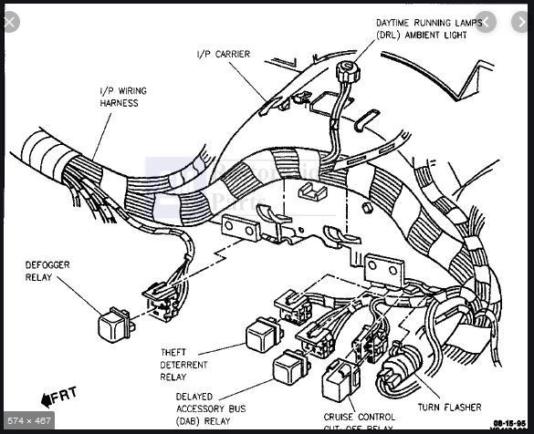

I was looking for the Starter Relay location and found 2 reference pictures, slightly different... the Delay Accessory Bus Relay is next to each it and they have the same part number, so I decided to swap them, same case, no Crank. I guess I can go back and check the Voltage across the relay and confirm that way. I also read there is a "fusible link" in the starter circuit, but couldn't find any reference to that location...
Starter Enable Relay
Theft Deterrent Relay
