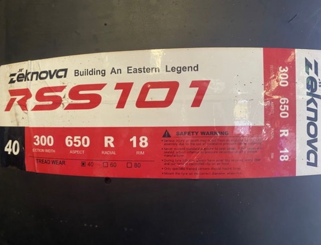

Do you think you can fit the 300s under the rear because I just picked up 10 of them (it’s a long story). 40 tread wear they are sticky not sure whether that’s good or bad for the drags. TBH I don’t think they will fit with the offset I have on those wheels or maybe any offset.

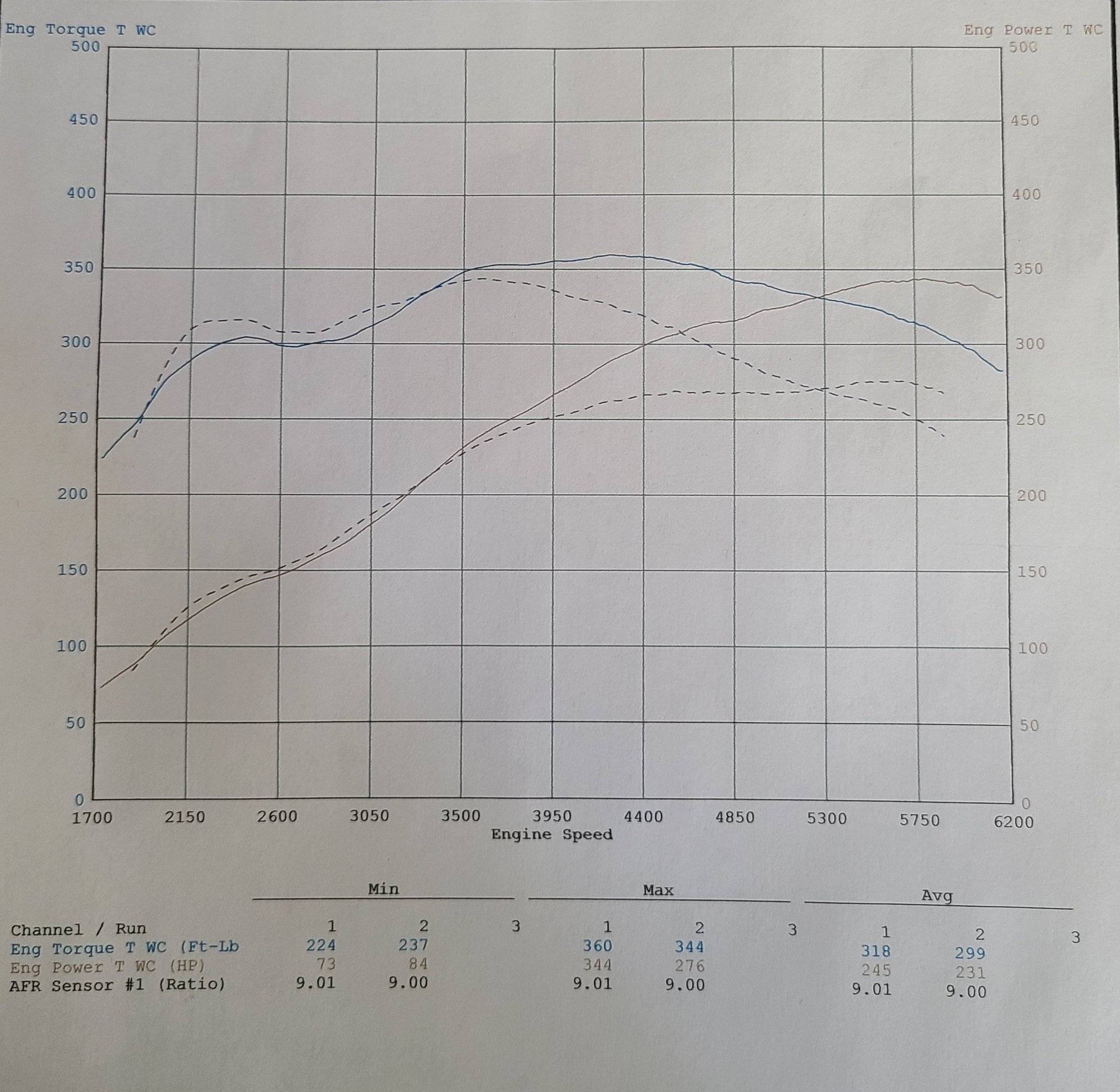

Originally Posted by 84 4+3
Pretty stout improvement and it didn't really lose anything meaningful down low. There is no correction on these numbers so what it made are the raw numbers just like the last pull. Being the DA was -400 feet for the old pull and today was 95 woth DA in the low 3000 foot range, that's a massive improvement.
So I've been thinking about this. The original claim was 30hp on a stock engine correct? Well... If you take a look at where the stock intake is about tapped out, we will say 4400 rpms, it makes ~270hp. Then the renegade makes about 300hp at that same spot. I think it is a fair deduction that claim could be true being you wouldn't be seeing the same air flow on the engine with the stock components until maybe 4800 or 5000 rpms... I know with the renegade my stock top end was ~5100 rpm and putting the stock intake back on it peaked around 4500 before it really fell flat.
Just another data point but if I could find some flow data on 624 heads we could surmise the air flow requirements at the rpms for the stock and renegade on the current mill and see how it compares on the original components...
There's flow data for the stock heads on Stan Weiss's site:
http://users.erols.com/srweiss/tablehdc.htm#Chevy
