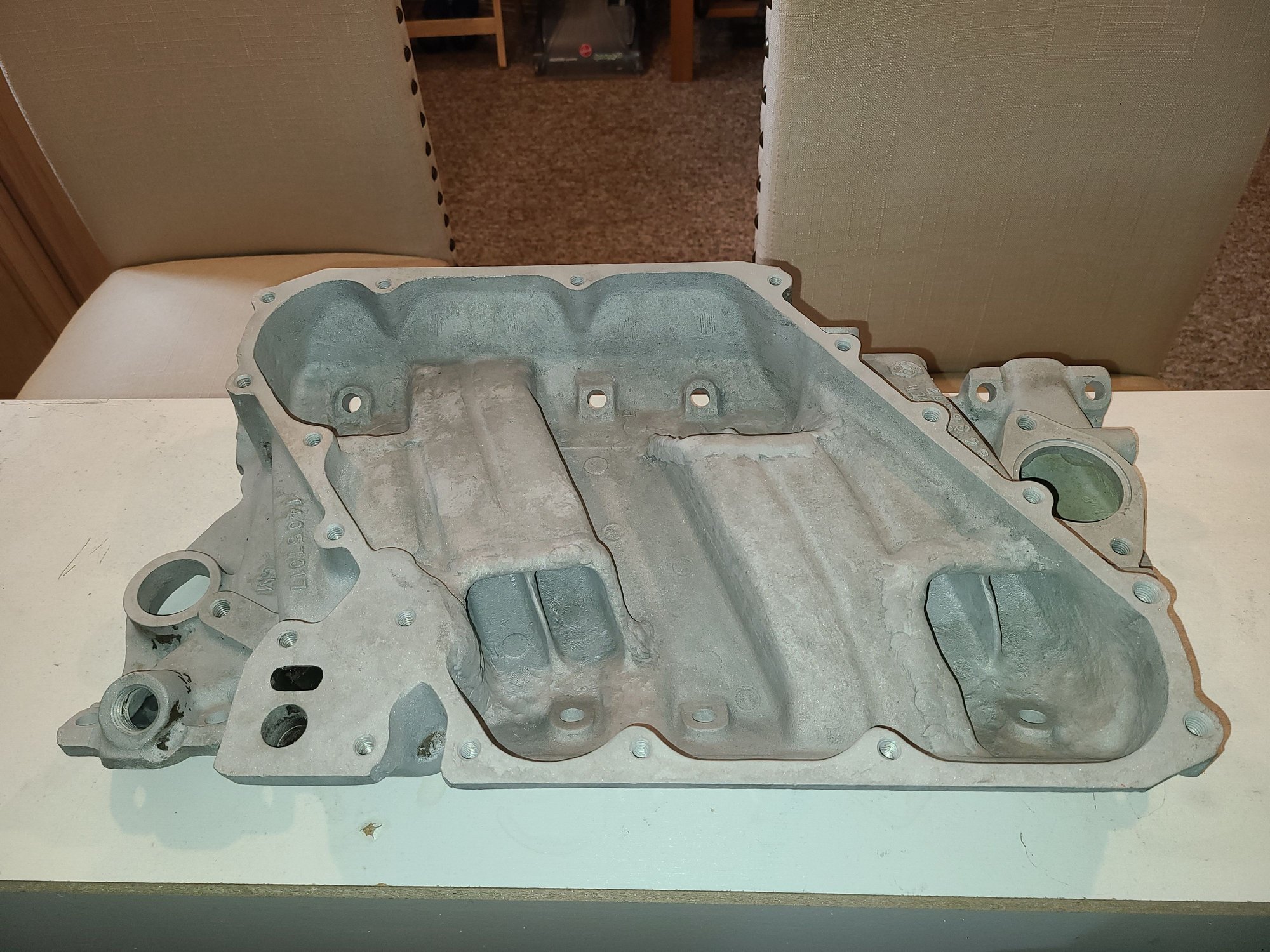

I think I've finished up... or at least done as much as I can. I've opened up the rest of the runners to the point a car fits through each evenly. Then I cranked up the pressure on my media cabinet and with a very wide tip ran blast media through each runner to knock down some of the roughness I can't reach... this is the result of all that work over the last month or two...
We'll see how she does...
Ironically enough I look at it now with all the modifications and it really does look like an L31 vortec base now...
