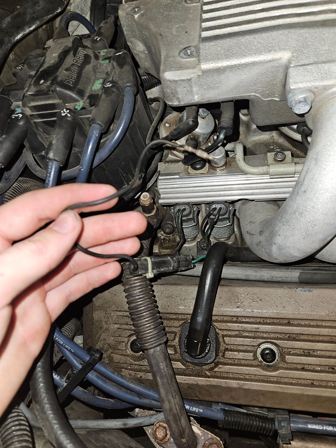

While eyeing my fuel leak nervously, I found a loose wire. So while we're at it, what does this do?

Its from the egr temp switch just behind your middle finger. See if you can screw it back in place. This is the reason for the Code 32 btw.
Got it screwed back in most of the way, should the white part be kinda loose in the housing? The wire threads in tight but the part it threaded into is loose from the rest of the egr tube.
