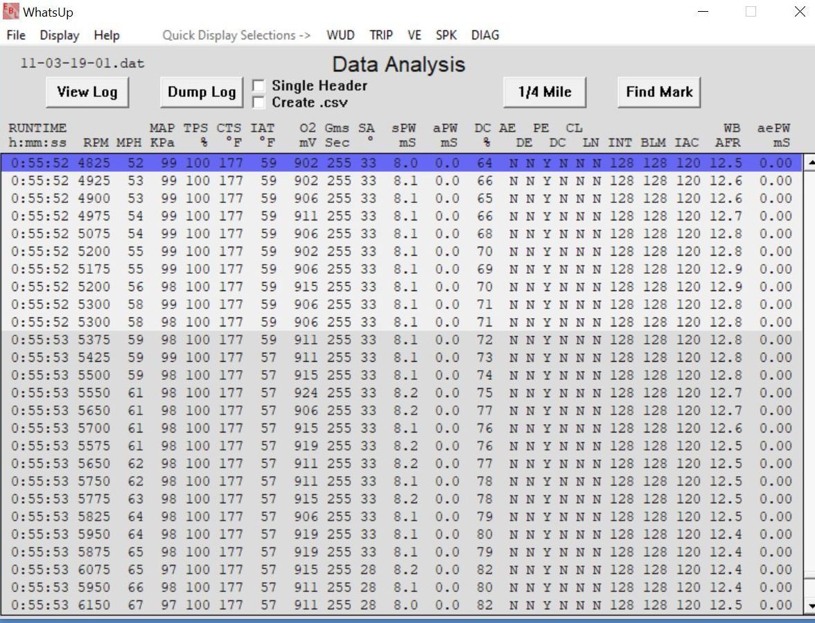

The early c4 air filter flows good (same filter was used in the c5) but the housing is a big restriction at the neck where it goes over the radiator. The late c4 housing won't fit early cars because they angled the radiator back to make more room over the top. With the stock housing connected to a 4 inch tube the restriction was dropping the MAP down to 92 kPa by 4800 rpm's. No room to go higher over the radiator but you can go wider. I fabricated a sheet metal housing that uses the stock filter. Now the kPa is 97-98 all the way to my rev limiter at 6200 rpm's.

With your fabrication skills I'm sure you can make something that looks much neater. The Data analysis table I posted is with Bosch EV14 35 lb/hr injectors. 12.4-12.5 AFR @82% duty cycle and 97-98 kPa I consider good enough air flow. The intake air temperature stays less than 10 degrees above ambient as long as I'm moving.
