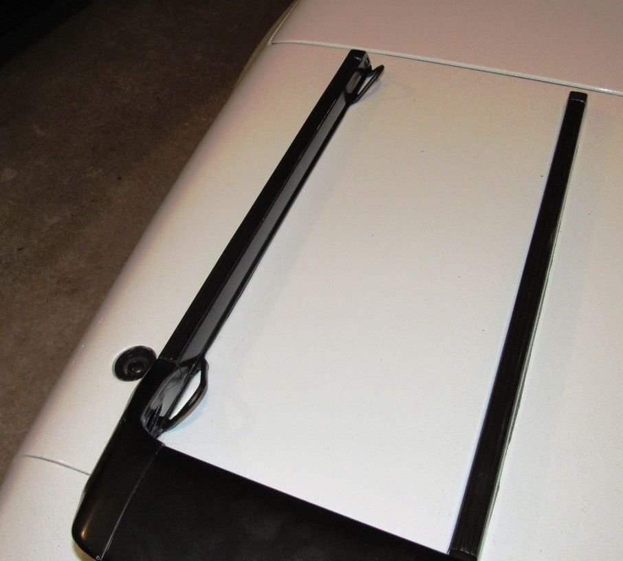

Default Luggage rack for Vert
So learned the hard way that the hook points on the OEM luggage rack are not as strong as I supposed they were. Although the track is aluminum, the hook points are a hard plastic. I snapped one by tightening the tie-down strap too much.
So here is my almost-free fix:
Get two pieces of 3/4"W x 19"L flat bar.
Bend up four metal loops and weld these to the flat bars.
Mark and drill the three holes in each flat bar, corresponding to the track.
Slide the new assembly under the existing track, and tighten down with the existing screws.
Now any tie-down strap can be attached to metal instead of to plastic.
The finished product:
