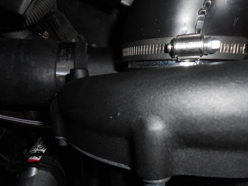

Also, I thought I answered but maybe I didn't..
Mine DID sit flush.. on the C6's you have to knock down the top edge of the radiator. Is that what is in the way on yours? Mine was basically touching the radiator afterwards, so I put some fabric/friction tape on the plastic piping where they touched to give it something to wear besides the plastic.
But..I think it should sit flush
I didn't modify the radiator at all so this may be the solution.
