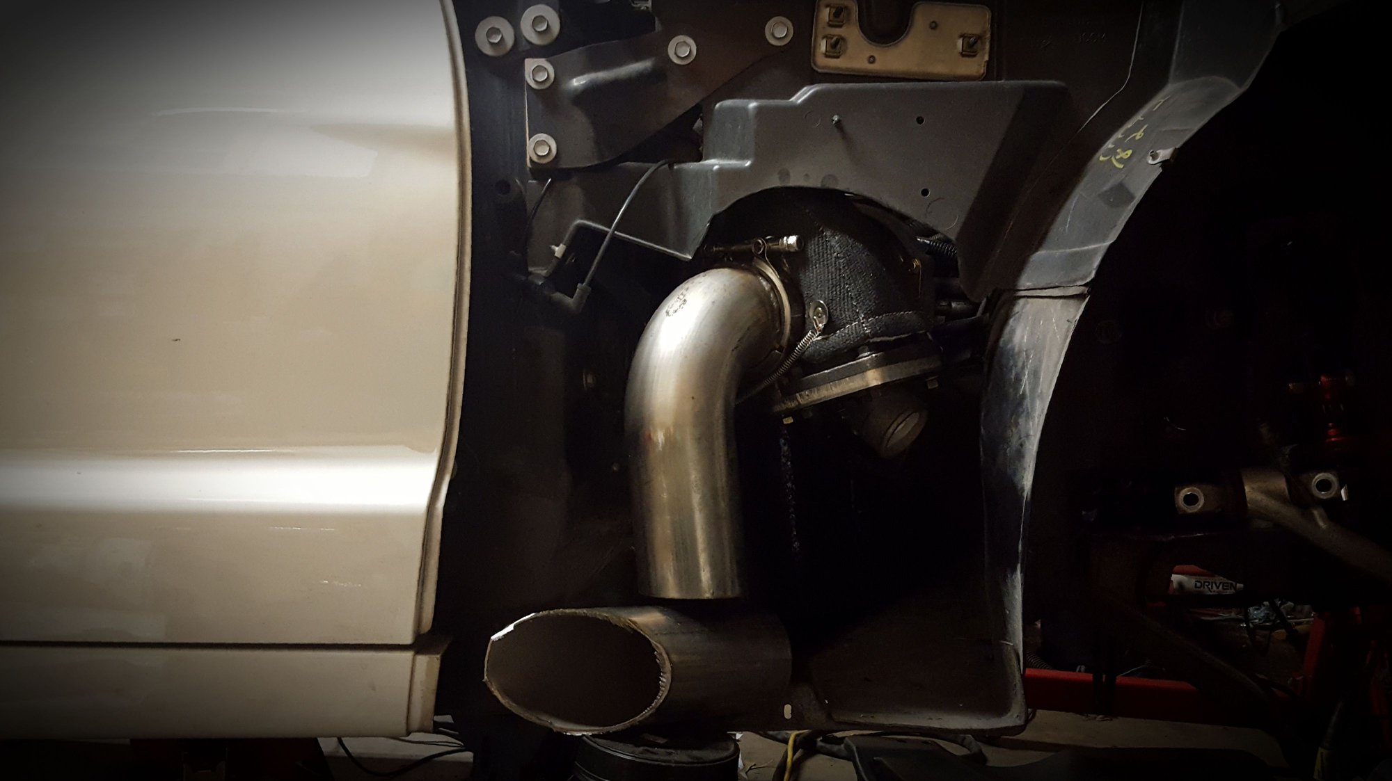

As mentioned, I've been discussing building something like this for a little while now. There are a few options out there these days for turbo kits that are readily available but I kept coming back to the idea of locating the turbo in the fender and routing the downpipe right out the fender. This picture probably shows the concept the best and is where the pro mod style name originates. The front half chassis mods on this car are a little farther than I want to go at this point, but the car will be getting a front engine plate this go round.

Paul Major put his turbos there in his 01Z.

Yes, I've found some of his past threads and online articles. They were in the trunk originally and then moved to this location?

I know most cars like that will never see any street use...but dont the turbos smoke like **** at that angle ?
or are they pretty tolerant of running like that ?
A friend has a car and his is mounted at a relatively small incline and on occasion is very noticeably smokey. But it's nowhere near the angle of those. ( His does make very good oil pressure too though, dry sumped etc so that could be a factor )
A bunch of race cars with their turbos mounted like that and I have never seen them smoke. I would guess it's their drysump/vac pump helping them out. They could also know something we don't lol.
