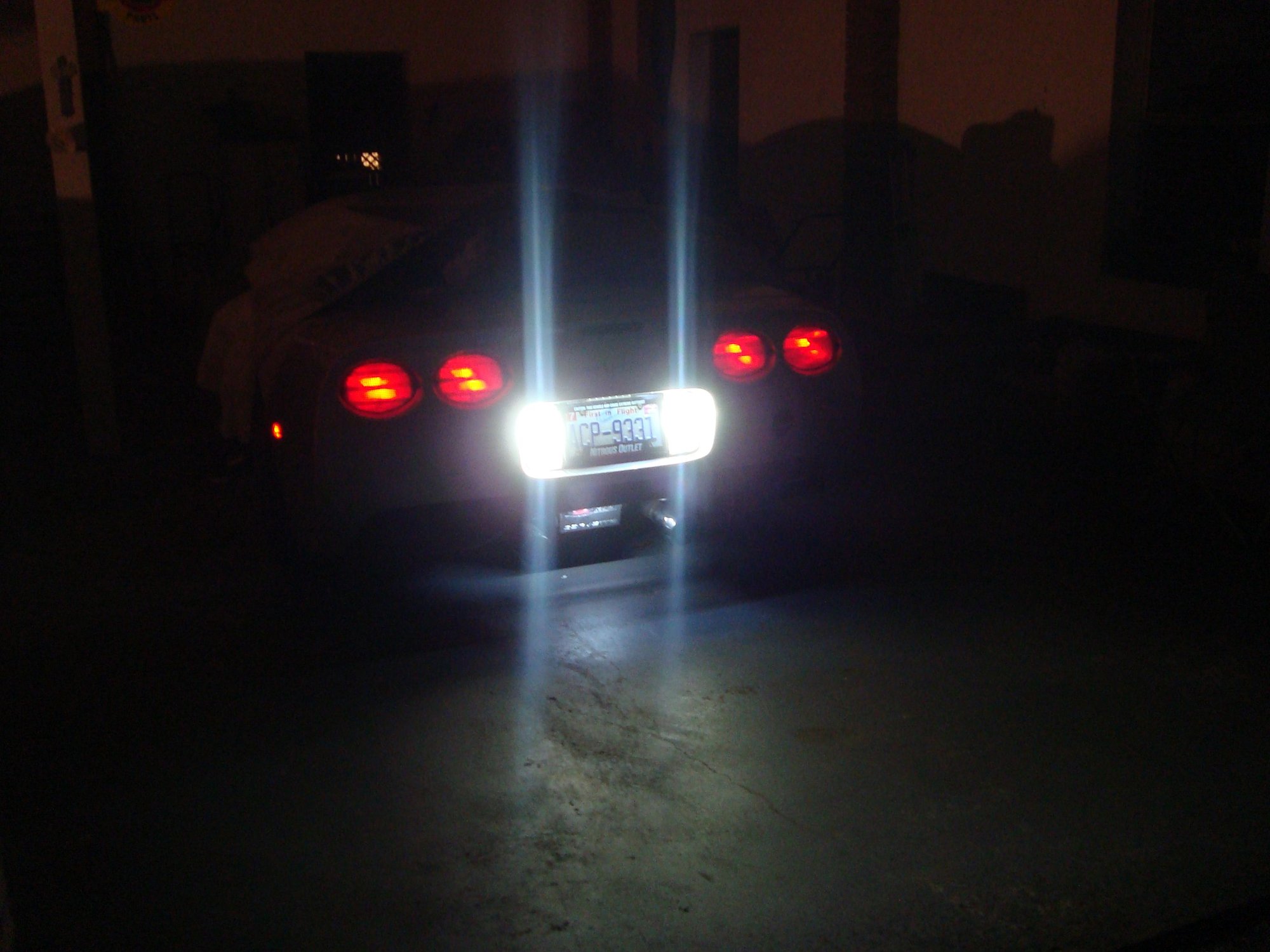

I know this is the interior LED mod thread but I installed these 80 watt Cree LED 1157's in my reverse lights today. Keep in mind my reverse light lenses have dark tint over them.
