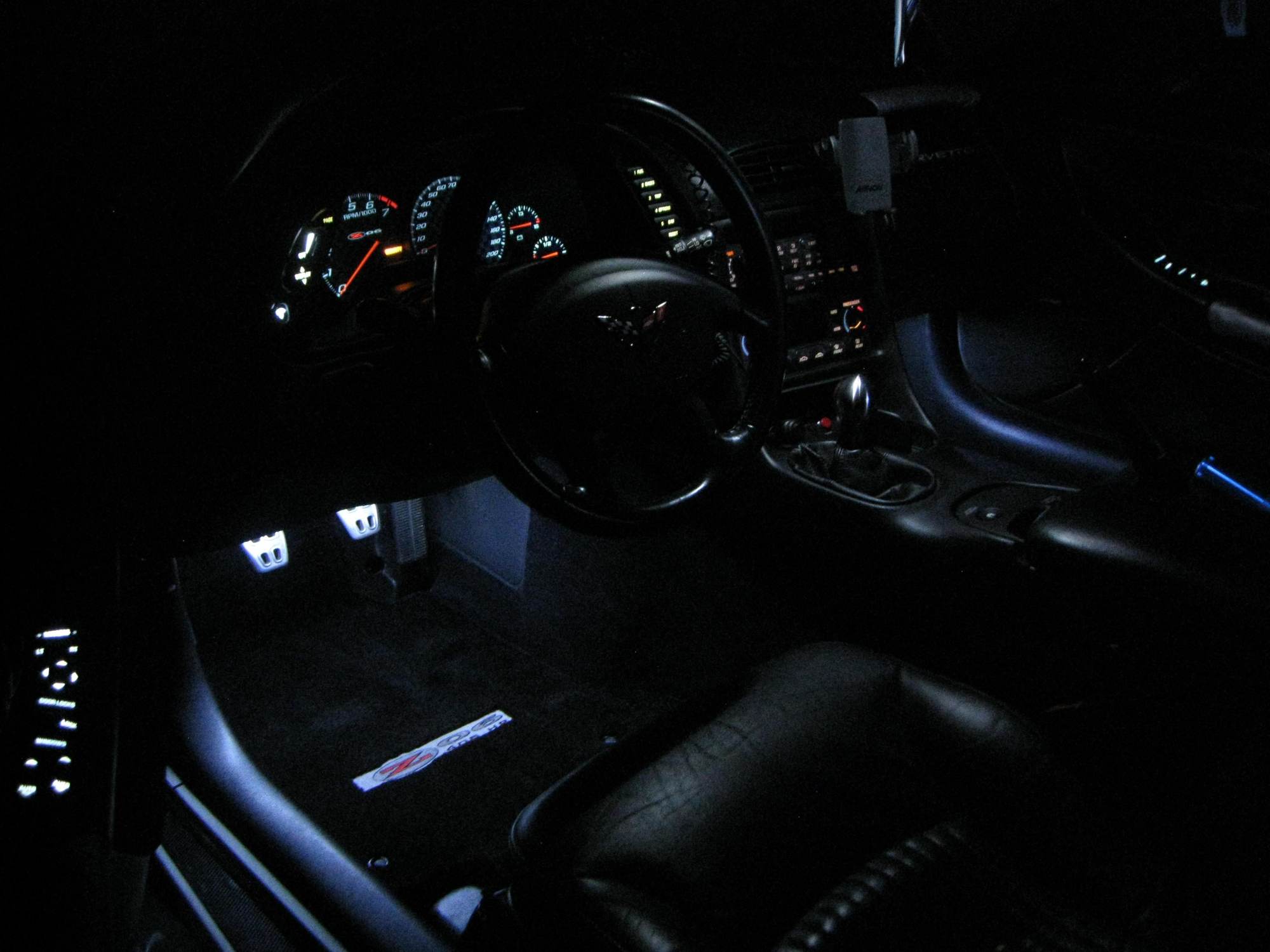

Originally Posted by tstar
Hi Guy!!!
Yes the LED strip mod in the PRRNDL is the way to go!!!!
Looks great! How much bleed out around the edges are you getting??
Tim
Hi Tim,
There is a little bleed around the edge of the plastic near the boot as you can see in the picture, I think this can be cured by sealing up the edges with some black material. The numbers and letters are really clear, I much prefer this to stock or even the 194 LED bulb.
