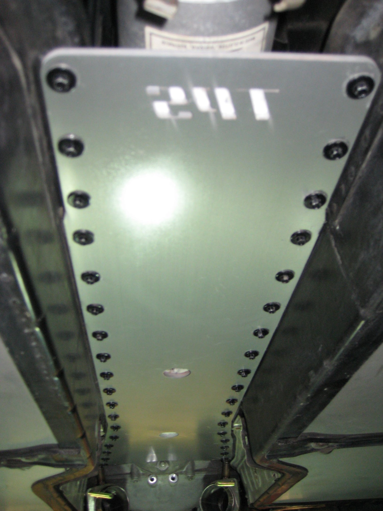

Originally Posted by Witmer
I'd consider adding a thicker chassis tunnel plate with heat shielding while the entire exhaust is out.
I'm taking mine in soon to ECS for header install and asked them about heat shielding while exhaust it out and they will add this to the list

Originally Posted by akapounder
Who makes that unit?
TPS Motorsports.

I just ordered this one...
http://www.eliteengineeringusa.com/1...h-thermal-abs/
