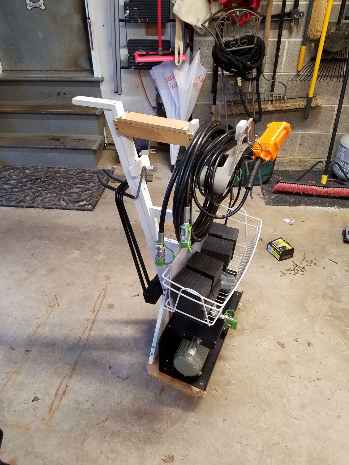

Created a cart for mine for ease-of-movement and storage:

K9 Leader, I like the basket and frame handle holder.

Thanks. You can see I ran out of the 1x2 PVC and had to supplement with "old-fashioned" wood. Tsk, tsk. Most of what I used I already had, although the casters, basket, and hose holder were purchased for this purpose. I took advantage of the early Spring snow days off of school to work on it.

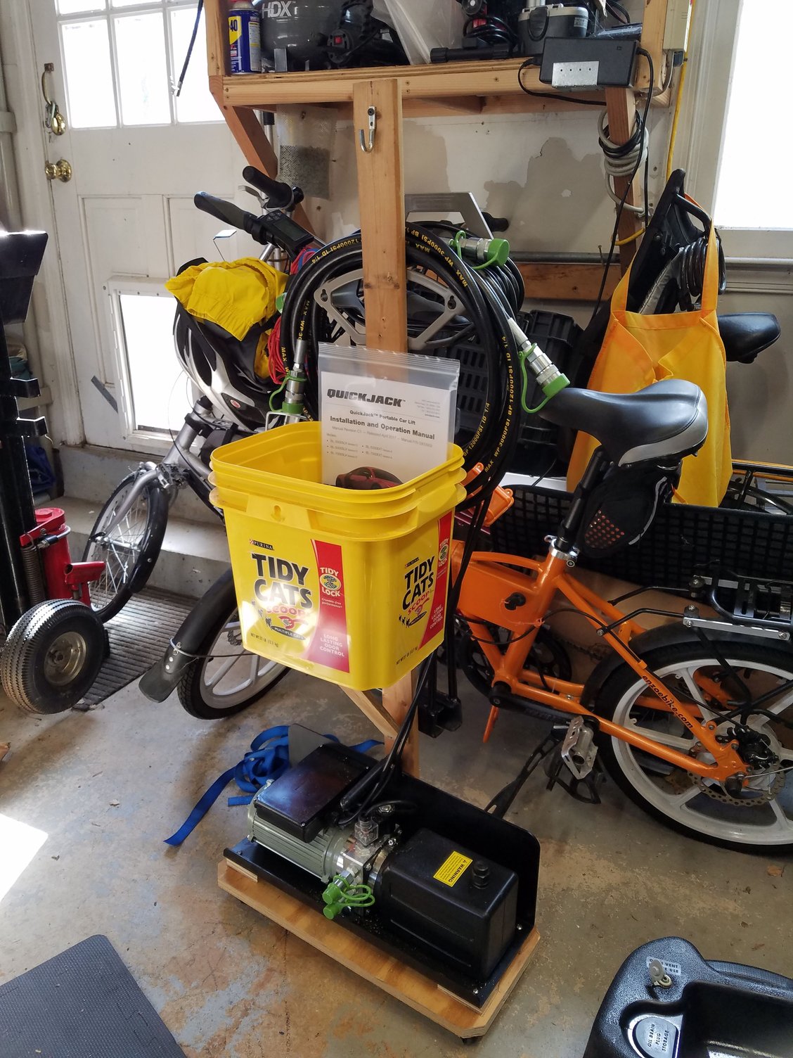

This was my first prototype/attempt:

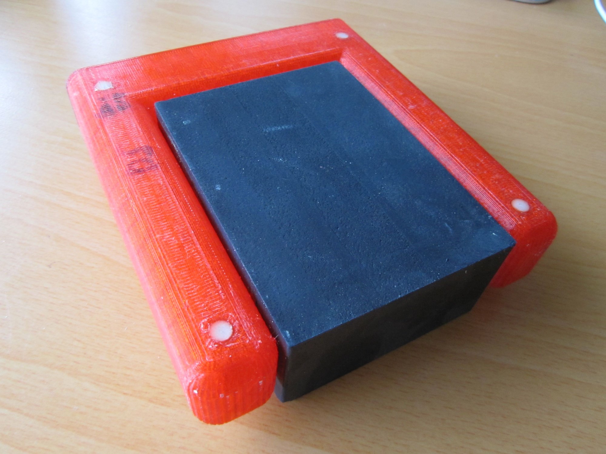

Some spacers help keep the rubber blocks from moving around and set the position to match the car; here the red is shown for the torch red car,

Good idea on the spacers. I have some white vinyl strips showing where they need to be and another stripe on the front that lines up to the furthest point of the wheel well (helps to line the jack up to the car... Then the other lines tell me where to put the spacers)
But I like the spacer idea. I might go cut some scraps of wood and do the same.

Great Idea!

Four small neo magnets were glued into the spacer bottoms and some Goop adhesive was added between the spacer and block, this allows the jacks to be stored on a wall with the spacer blocks in place but they can be lifted out if needed. One spacer assembly is shown upside down,
Also, if your car is lowered mill down the short rubber blocks to about 1.52" thick for maximum clearance as the one shown above.
