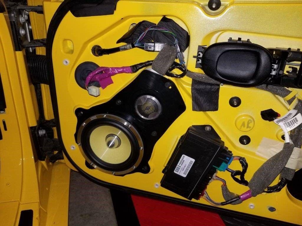

I did a complete overhaul. Sound deadening, Focal components in the doors, Focal coax in rear.
Replaced brake boot, shift boot, and center console cover with leather from redline goods. Also installed MGW flat stick shifter.
2 JL 10W3 in FRC partition box from subthumb.
Everything powered by an Alpine A90V. Still need to do a little more adjusting on the HU alignment.

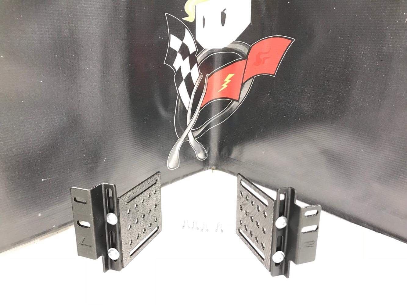

I placed my double din order with marc today, and ordered the new brackets. He sent me some pictures and They look amazing!

These are what he sent me.

Ok they are up on the web site: VetteNuts Double Din Radio Brackets
We had to revise them after the first go round. We were not happy with overall strength so the material was upgraded and we could not be any more pleased with the results. If you ordered a set of metal brackets include your order number at checkout for a $9 refund.
​​​​​​VetteNuts Double Din Radio brackets are printed out of the extremely strong Z-ULTRAT which is a high strength thermoplastic, producing stronger products than similar injection molded pieces. This design was specifically made to allow any double din stereo to fit into the c5 corvette with no modifications. These brackets are engineered to be fully adjustable left/right, up/down, back/forth so as to ensure perfect alignment of your radio with our Double Din Bezel.
