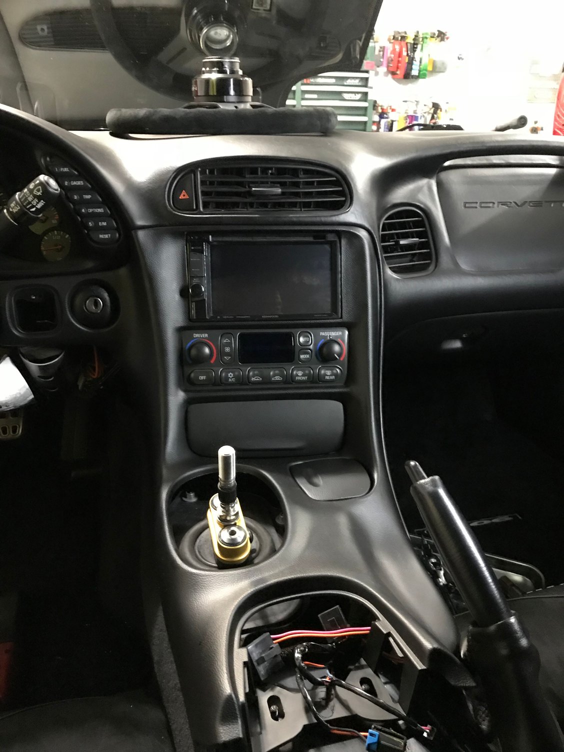

Finished up my install last night, thought I'd post a few pictures. I did have to modify the "not so universal" mounting brackets, but with a dremel and shim washers got the HU where it needed to be. I did have to shave about 1/16" to 3/32" off the top side of the piece between the HU and HVAC so that the door on the HU would operate properly. I may order the new composite brackets and install them the next time I have to take out the console.
That turned out really nice! Your gonna love the new brackets.

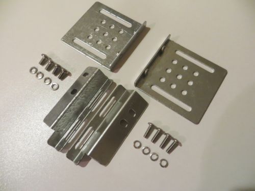

If anyone gets their DD unit mounted with Marc's new adjustable brackets PLEASE post up some close up pics before the bezel is installed. I think seeing the brackets in place on the headunit and to the dash frame would be helpful.

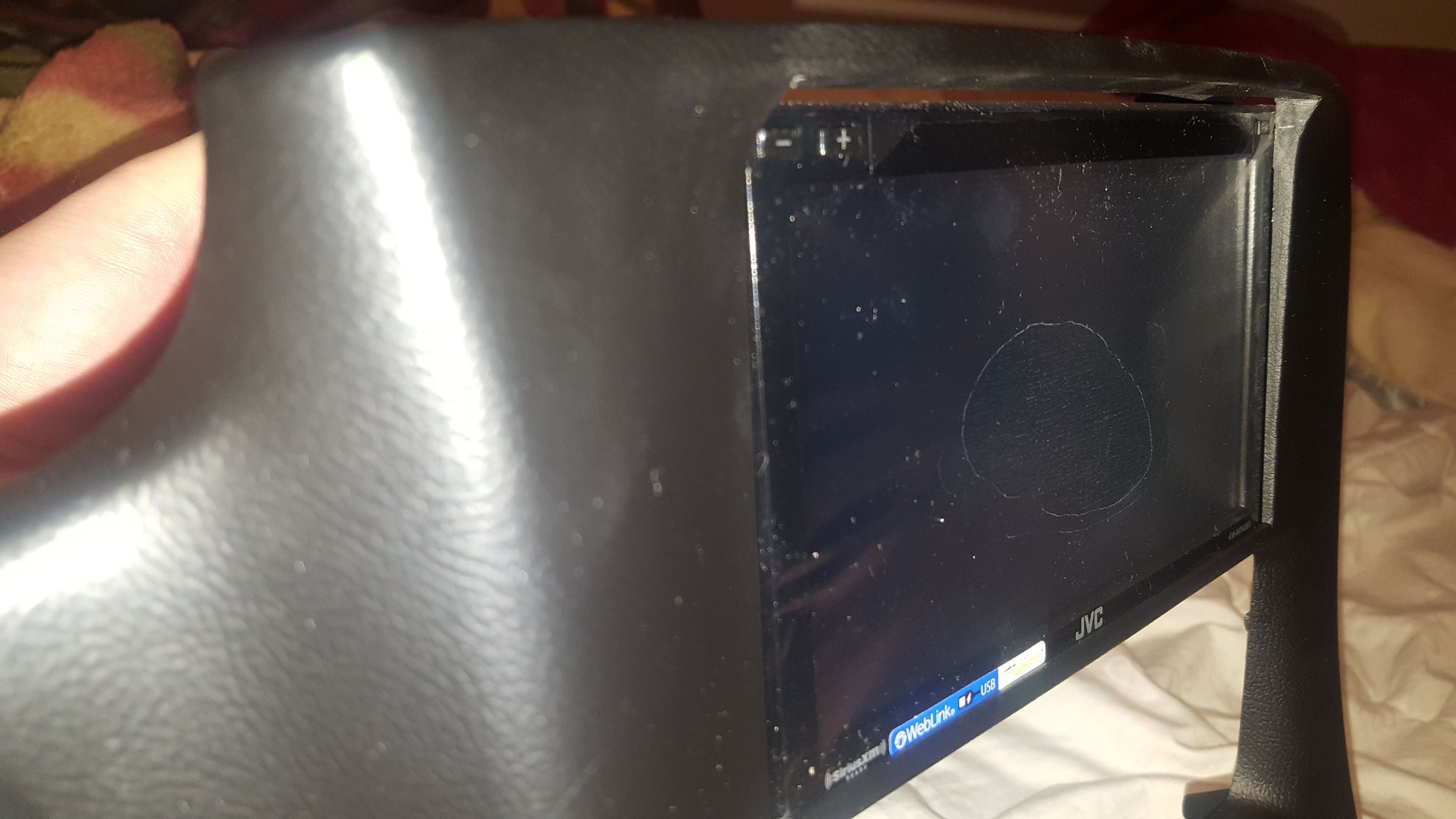

Received my bezel + 3D printed brackets today. They forgot to send me screws, does anybody know what specs the screws are so I can just buy some at the local hardware store?
Also: those of you that shaved your bar between the HVAC and head unit, what tool(s) did you use to do this so that it came out looking good? If a dremel, what "bit" or tip or attachment did you use? I definitely am going to have to do this. My head unit would fit its face through the hole fine if it wasn't for the two tabs at the top hitting it really early.
Has anybody just deleted the two tabs from the top of the bezel? I have a feeling I'm going to need to do this, like it or not. Will the bezel still hold in place? Maybe I'll try an adhesive once I'm begrudgingly forced to remove these damn tabs...
Old May 8, 2018 | 11:02 PM
  #69
lancedolan's Avatar
lancedolan
Joined: Jan 2018
Posts: 92
Here's what it looks like with the head unit pressed HARD against the tabs at the top. Still doesn't actually get into the opening.
Old May 8, 2018 | 11:08 PM
  #70
lancedolan's Avatar
lancedolan
Joined: Jan 2018
Posts: 92
Actually, I just realized mine doesn't fit side-to-side either.
Has anybody widened theirs side to side?
Somebody will probably want to know; it's a jvc kw-m740bt.
I called Marc before buying specifically to find out which head units to avoid buying for fitment and he said as long as it's 7x4, then it should fit, and all major brands will fit. I consider JVC a major brand (it's the only brand as of right now offering wireless android auto besides kenwood), and the dimensions say 7 x 3-15/16", which is less than 7x4, so I'm really surprised it doesn't fit.
i r dissapoint.

Looking up dimensions on some of the other head units that were successfully installed:
Kenwood dnx893s: 6-3/16 x 3-3/16 inch
AVIC 5200NEX: 6.5"
It looks like you need a head unit that's less than 7" wide.
Old May 8, 2018 | 11:38 PM
  #72
lancedolan's Avatar
lancedolan
Joined: Jan 2018
Posts: 92
The bezel only has a 6.75" opening. The head unit is exactly 7" as Marc advised me to purchase.
I would suggest that you do NOT cut the top tabs off as the bezel will likely not fit flush with the opening without the top two tabs.
Once they are cut off they can't be put back on.
AVIC 5200NEX: 6.5"
I am installing a Pioneer AVIC 5200NEX and I needed to sand a small amount off the left bottom side to allow the bottom of the 5200 to fit flush. The issue was caused by the way Pioneer designed that 5200 and it's "removable" switch panel which protrudes a bit farther down under that panel than the remaining front panel edge.
Mine also has a narrow gap across the top. I used some black rubber weatherstrip applied to the top of the unit to compress and fill the gap so that it is not visible once installed. Pretty sure the black rubber weatherstrip was left over from some aftermarket rear tail light "seals" for the C5.
None of these issues was Marc's fault. I don't think anyone could design a bezel that fits all DD units without any "fitting" by the installer.
I've read all of your posts, you've been the most detailed, so I'm really aware of the weatherstripping at the top that you and others did. That doesn't bother me what so ever. I was already planning on doing it as well.
While your fitment issues aren't Marc's fault, mine definitely are. He's selling a 6.75" wide product, I called him on the phone to ask what the dimensions are on his product, he told me 7x4, when I asked "are you sure because I know they come in slightly different sizes," he assured me that 7x4 is good. I wrote down 7x4, I purchased 7x4, and the opening is 6.75". A quarter inch is a lot of plastic, and I don't think I could keep my hand straight for 4 full inches length of cutting. The opening on these already look fantastic, it's a risk to take out that much. Taking 1/8" off both sides isn't something I can do while guaranteeing that I won't destroy my $400 bezel. I've already started the return process on this head unit. Looks like I'm only losing 1 week and $10, the 1 week being the greater frustration.
Of course that's true, they come in slightly different sizes. Not only do I agree with that 100%, but it's precisely the reason I called him and asked multiple times what the dimensions are so I could ensure I buy one that fits the precise measurements of the hole. It's just a 2 dimensional hole that I'm asking about, not complicated geometry.
Others who want the freedom to shop head units rather than buying only one they've seen successfully installed in a forum post will have the same question as me, so it's good that I'm posting the info here, and hopefully Marc notices as well.

Originally Posted by oneandgone
Nice! So the new brackets are winners? I haven't had a chance to mess with mine yet. Any pics of the HU and brackets without the bezel? What was the level of difficulty in getting the brackets/hu adjusted right?
Be very careful with those plastic brackets and make sure you carefully enlarge the mounting slots if you plan to use the original mounting spot on the car's framework as the slots are a bit too narrow to fit the slots on the stock mounting posts.
And if you don't file/sand then to be a bit wider to fit over the existing stock metal posts..........you may break the brackets......as I found out the hard way. Afterward, I ended up building my own brackets from some galvanized metal that are very strong. But it took quite a while of trial and refit to get my homemade metal brackets to position the head unit just as I needed it.
I installed the same H/U and had the same issues as you. Like you said earlier, had to file a little on the lower left corner of the bezel because of the button panel. Also the 3D printed brackets the I got from the original maker seemed to separate very easily. My assumption is, since they're built by layering, the bond between layers isn't that strong and can be separated pretty easy.
Mine didn't separate, they broke in half in several places.
To prevent this the brackets would need to be made of metal. There used to be a seller on eBay that sold the exact same design in aluminum for $49.95. (See below)But seems to have no more for sale.
I sent an email to VetteNutts, got a reply and they quickly refunded my $$.
I don't have any gripes about VetteNutts. Both the bezel and the brackets are new products for them and it is not unusual for new products to have some issues. I applaud Marc for taking a risk and having these bezels designed and built for the C5 community.
A "one size fits all" bezel doesn't exist. The DD head unit sizes vary widely and the sizes may change with each new model. I expect that the same issues can be seen with the Metra bezels. The hand modified bezels like Dennis at Double D used to make were hand built to fit the specific head unit they were installing.
