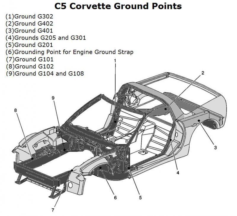

Ground locations/here are more locations ....
________________________________________
Since Corvettes seem to have issues with grounds, I have compiled a list of the Ground locations and the circuits attached with each ground for reference purposes. I thought others might benefit from this list.
Ground locations
From 2003 Corvette Shop Manual
engine ground strap top left frame behind left front wheel well
G101 left front frame (with SP101)
G102 right front frame (with SP100)
G103 left front of engine
G104 frame next to battery (with G108 & SP102)
G105 left lower engine block, engine ground strap & wire
G106 Battery negative pole
G107 Left rear head
G108 frame next to battery (with G104)
G201 bottom of A-pillar, left (with SP201 & SP203)
G202 bottom of A-pillar, rt, bolted at the bottom (with SP202)
G205 inside door pillar driver seat (with G301)
G301 inside door pillar passenger seat
G302 inside door pillar driver seat (with G205)
G401 left rear outer frame
G402 right rear inner frame
SP201 bottom of A-pillar, left (bolted with G201)
SP202 bottom if A-pillar, rt (bolted to G202)
SP203 bottom of A-pillar, left (taped to wire bundle, with G201 coming out of it)
G101: windshield washer fluid pump
Windshield washer fluid level switch
Brake fluid switch
Headlamp door assembly, left
G102: cooling fan, right
Cooling fan 3 relay 44
Horn assembly
Under hood lamp
Headlamp door assembly, right
Headlamp door control module
A/c compressor clutch
A/c compressor clutch diode
Secondary air injection pump
G103: Electronic brake control module (ebcm)
G104: battery negative pole
Splice pack SP102:
Marker lamp, right front
Marker lamp, left front
Park/turn signal lamp, right front
Park/turn signal lamp, left front
Turn signal lamp, right front
Turn signal lamp, left front
Splice pack SP208:
---End Quote---
Body grounds c5
