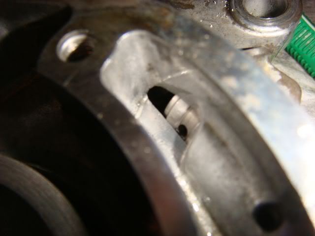

I took the oil pump apart anyway, since I had it out, and I found the pressure regulator stuck open a little bit. I took it apart and sprayed it with Electra-Clean (like brake cleaner on steroids), coated it with some oil, and worked it in and out several times. It is fine now and moves easily. I guess maybe, some of the fibers had it wedged in or something.
What would the pressure regulator being stuck open like this do to the oil pressure?

Starting with cold oil I would expect you will still see some oil pressure even with the part open relief valve. The relief typically opens at start with very cold oil when the viscosity is high. The relief will also open at higher engine rpms around 3000 and above, again depending on oil viscosity.

What brand of oil filter are you using? And yes a stuck open P/R valve will cause little or no oil pressure.
But most importantly, your oil flow go like this. From the pickup screen into the pump then into the filter then through your cam & main bearing and lifters, rods.............See where this is going?

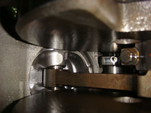

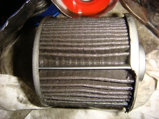

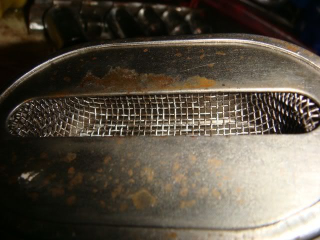

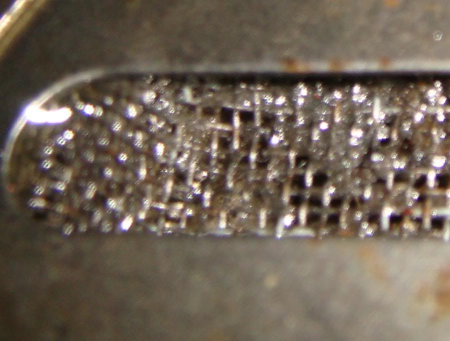

This is the material that was clogging the pick up tube. It was completely covered, but I sprayed it and hit it with a brush before I thought about taking a picture. Sorry, it's a little blurry.

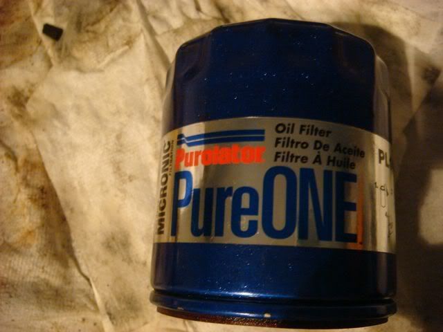

Here is the filter that was on the car:
I took it apart as suggested and it doesn't look to me like it is blatantly falling apart. but the fibers look just like the fibers in the pick up tube.
This is the pick up tube after cleaning with a brush and some nasty chemicals. You can still see a few fibers. They were incredibly hard to get off of there.
Inside motor. Hopefully no damage is done to the bearings. I can see oil dripping off of everything, so it wasn't completely oil free before it was shut off. I thought about taking a rod bearing cap off to take a look at the bearings.

Edit: OK I just remembered that I still had my last pure-one filter in the drain pan. I cut it open and found that it just looked like an oily filter. If you look at your picture, you can see that the fibers coat the filter. I bet if you wash that filter with some laundry detergent and hot water, all that fiber will wash off and you will have what looks like a new filter underneath with no deterioration!
Here is what I would do. I would install a new filter, run the car in the garage for 20 minutes and monitor the oil pressure. Just let it idle, if oil pressure drops, shut it down. Then remove the oil filter and cut it open. If you find debris you know its a rag and you need to do more flushes or take it to the dealer. I understand the dealer has a rig where they can remove the sensor and install a flush rig to flush out the system. Something to think about.

Hmmmm.......I guess I'll take the paper element completely out and see if the inside has the fibers on it. Since oil flows from the outside to the inside of the filter, it should be fiber free. Also, I still have the old oil. I think I'll get a paint filter, pour the oil through it, and see what is left in the filter. I can't imagine it's a foreign object. There is nothing in the old oil that you can see (like large pieces).

True, the inside of the filter should look just oily.
The quick and cheap route is to run the engine and cut another filter, otherwise it will cost you a couple hundred bucks to remove the intake and run the flush.
