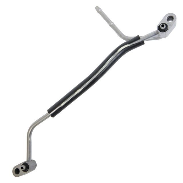

Where are these plate located ? I am a bit confused as to what to unloosen and try to remove air that may be trapped. Is there a picture that someone could send me as to what I am looking for? Thanks
Old Jul 4, 2021 | 04:16 PM
  #72
Marco 1976's Avatar
Marco 1976
Joined: Jun 2021
Posts: 36
From: Southeast Louisiana
Where are these bolts on the plates located ? I have no idea where the plates are. Obviously there are two one on passenger side and one on drivers side If anyone has a picture/diagram I would love to see it Thanks ran hot also and changed thermostat and it ran hotter quicker I would love to know if it was an air issue and need to see how to properly get air out of the system
Old Jul 4, 2021 | 04:59 PM
  #73
Smoken1's Avatar
Smoken1
Joined: Apr 2013
Posts: 5,030
Likes: 1,156
From: Oregon
Did you use the proper refill procedure?
Recommended procedure removing any air after changing coolant:
1. Close drain valve after old fluid is out.
2. Fill via the surge tank (50:50)
3. Start engine and idle for 1 minute before closing surge tank.
4. Install surge tank cap.
5. Cycle from idle for 30 seconds, to 3000 rpm for 30 seconds, and continue this until coolant temp is 210 F (99 C).
6. Turn off engine, take off surge cap, restart engine, idle for 1 minute.
7. Add coolant till 1/2 inch above cold full mark, then put the cap back on.
8. Cycle from idle to 3000 rpm just like step 5 until it reaches the same temp.
9. Turn off engine, add coolant till 1/2 inch above cold full mark, put cap back on.
The pipe they are talking about is this one...
