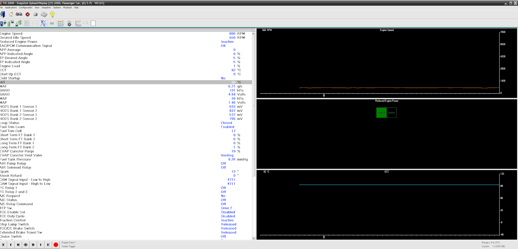

I have used it to upload captured data from Tech 2 and view the trend signals of the captured data on the pc with TIS 2000

I hope TIS2000 can give more useful info regarding troubleshooting on C5 than a colouring book .
The Tech2 can record snapshots ( two I think) of a number of parameters
. These snapshot recordings can be started by a DTC or manual started pressing the Tech 2 keypad .
These snapshots can later be uploaded from Tech 2 to the PC with TIS2000 and replayed as shown on the sceendump below .

Ok, well that's pretty cool then. I couldn't find a use for it. I hadn't looked into data captures mostly because I've got HPTuners. But still, that's a neat feature for someone who doesn't have another way to do a datalog.
