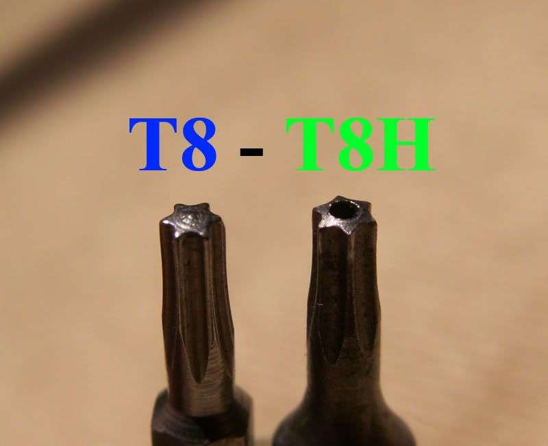

I am trying to replace my throttle body with a slightly larger one on my 2004 Corvette. I have the 5.7L engine. On the drivers side of the throttle body is a drive motor which drives the gear on the throttle body. I cannot seem to disconnect this from the throttle body to transfer it to the new one. Any suggestions? It appears to be held in place by four bolts that have star shaped heads but I can't find a tool to match up. It is a special tool?

Does it look like this? If so it is called a Torx bolt (pic shows a torx screw)

If I remember (and I have a bad memory) it is a torx with a small "pin" in the middle that will not allow a "standard" torx to be inserted. It is a "special" tool that has a small hole in the torx for that pin.

If the screws are like the ones used on the LS2 TB, they are not a regular "Torx", which is 6-point.
The LS2 TB uses a 5-point fastener. If it has the pin in the middle (which most do that I have seen) it is called "Tamper Resistant TORX Plus". OTC makes a set of bits for use on 1/4" and 3/8" drive ratchets. Part #5905.
https://www.google.com/url?sa=t&rct=...Ue8Ep0DjSIBnDw
Example:
Regular Torx, size 15 = "T15"
5-point Tamper Resistant Torx PLUS, size 15 = "IPR15" (Some refer to this as "TP15")
Complicated, I know.

Yes it does. Guess I don't have the right tool. And, no, I have not made any other mods yet. Thoughts?

If you have a Harbor Freight close by,they carry a complete set of torx security bits along with almost any other bit you would need for about $10.Standard torx won't work due to the security pin in the center.
