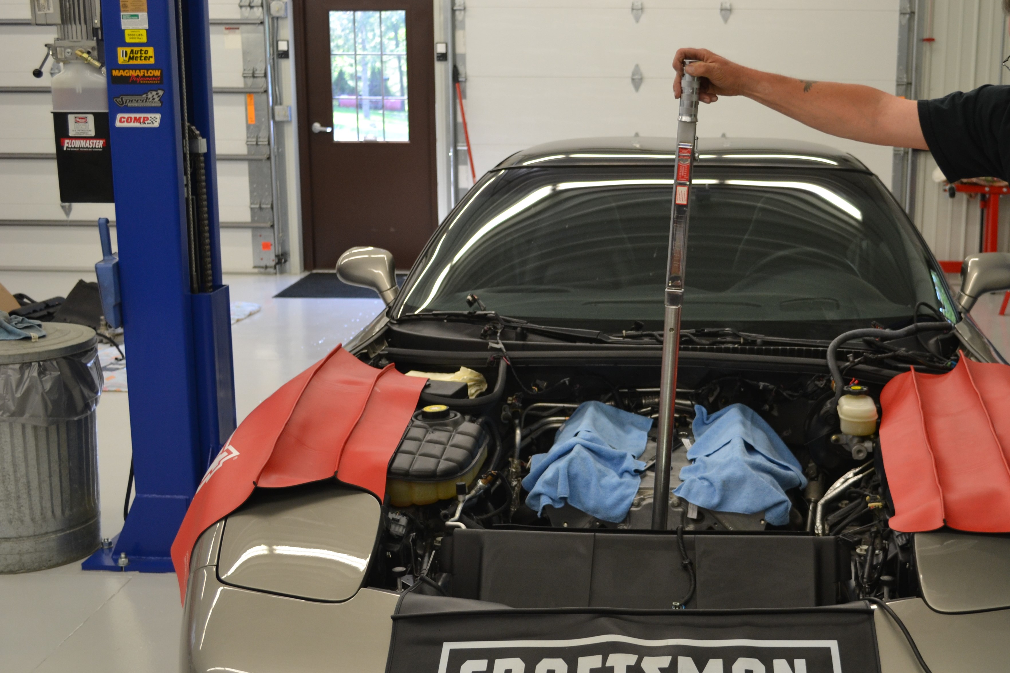

here's the torque wrench ya need for this job
Attachment 48235809
Thats essentially how I did it from the top. My torque wrench is almost 3 feet long. That thing you have is a monster. Semi truck wheels?
