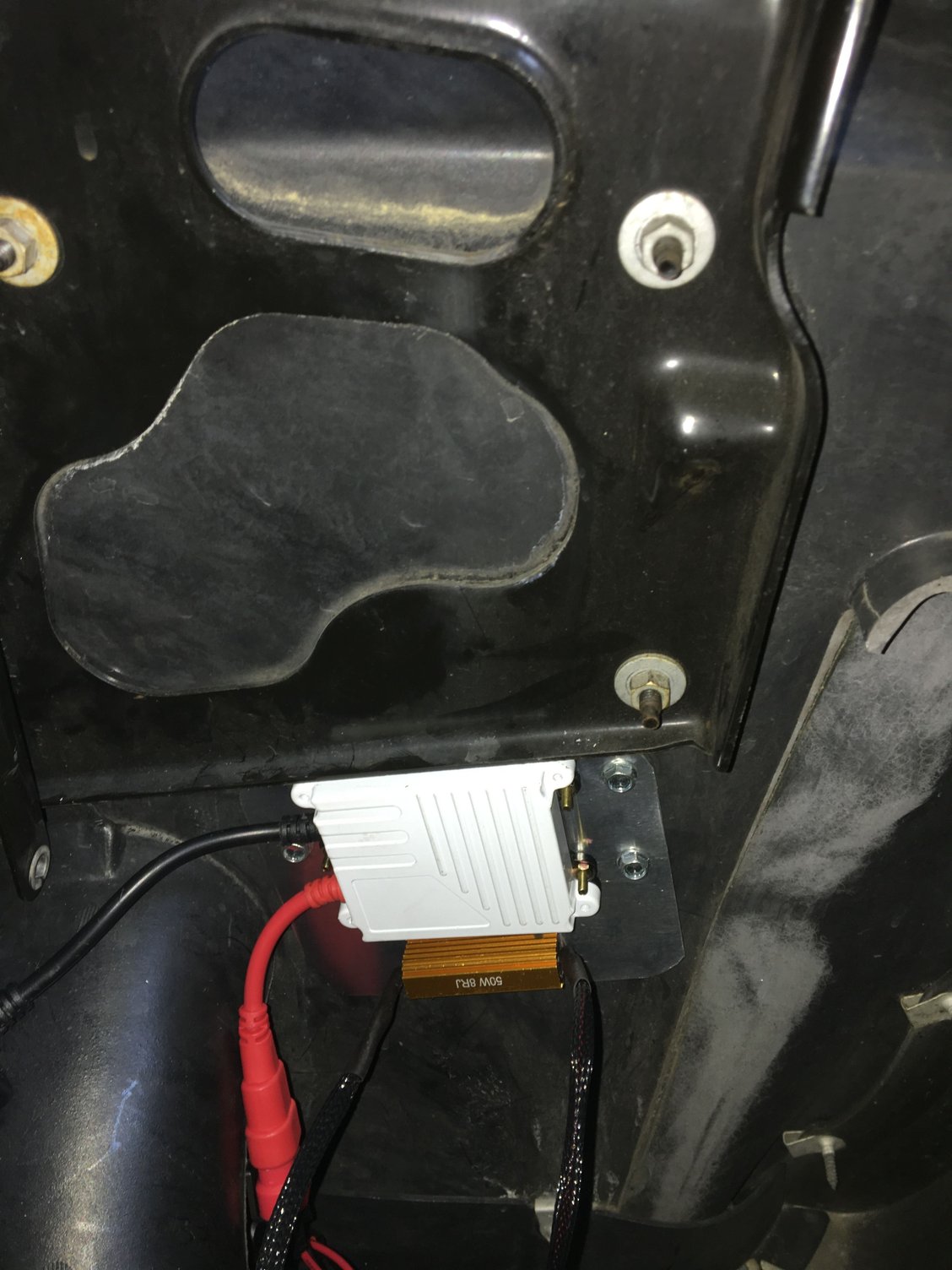

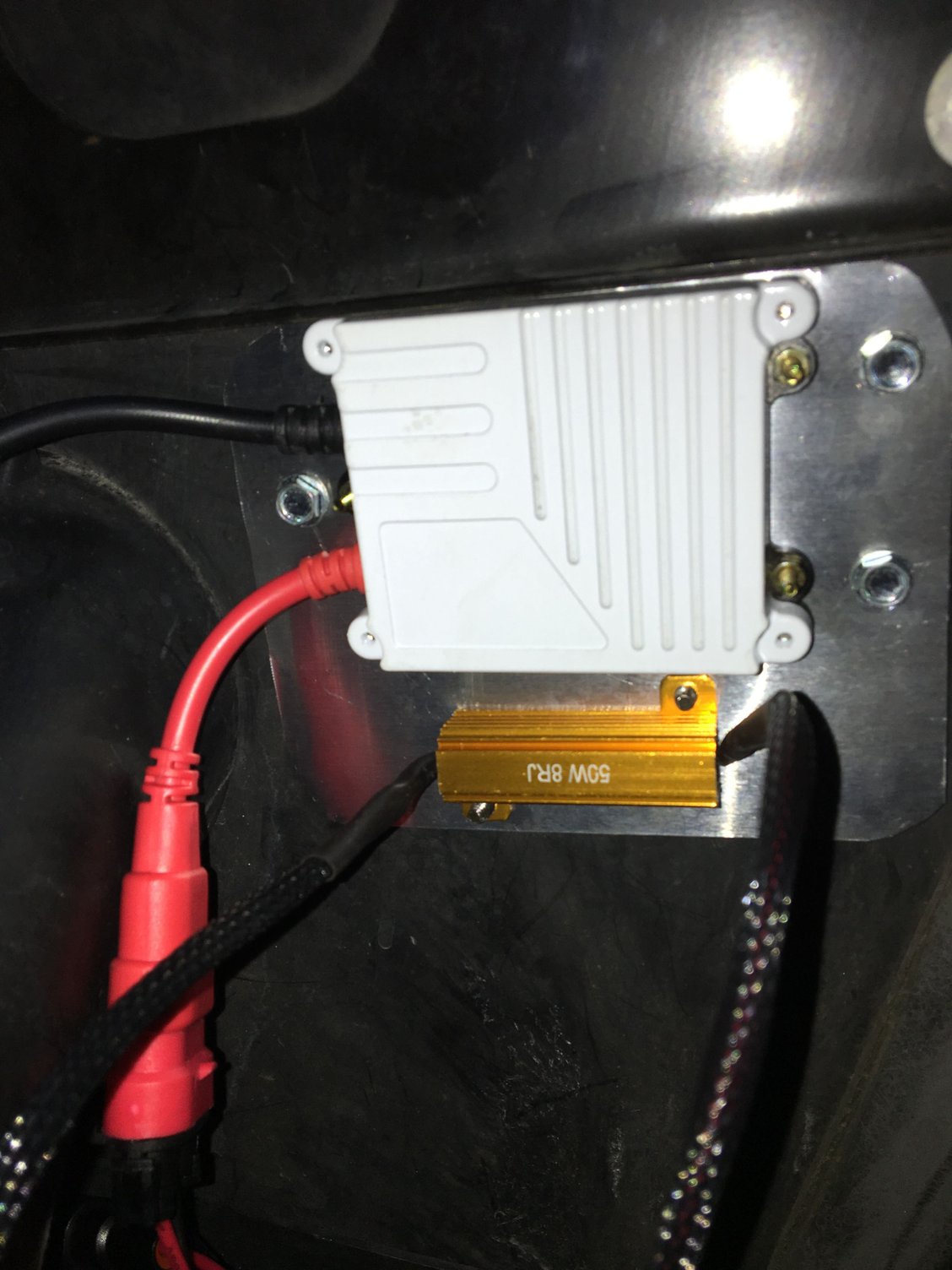

I just spoke with the people I purchased the motors from - they suggested I simply reverse the 2 wires that run down to the motor from the harness - this sounds simple enough.
Should the new ballasts have insufficient resistance I'll look at other posts for guidance

Polarity on the motors switched and resistors installed - it works
