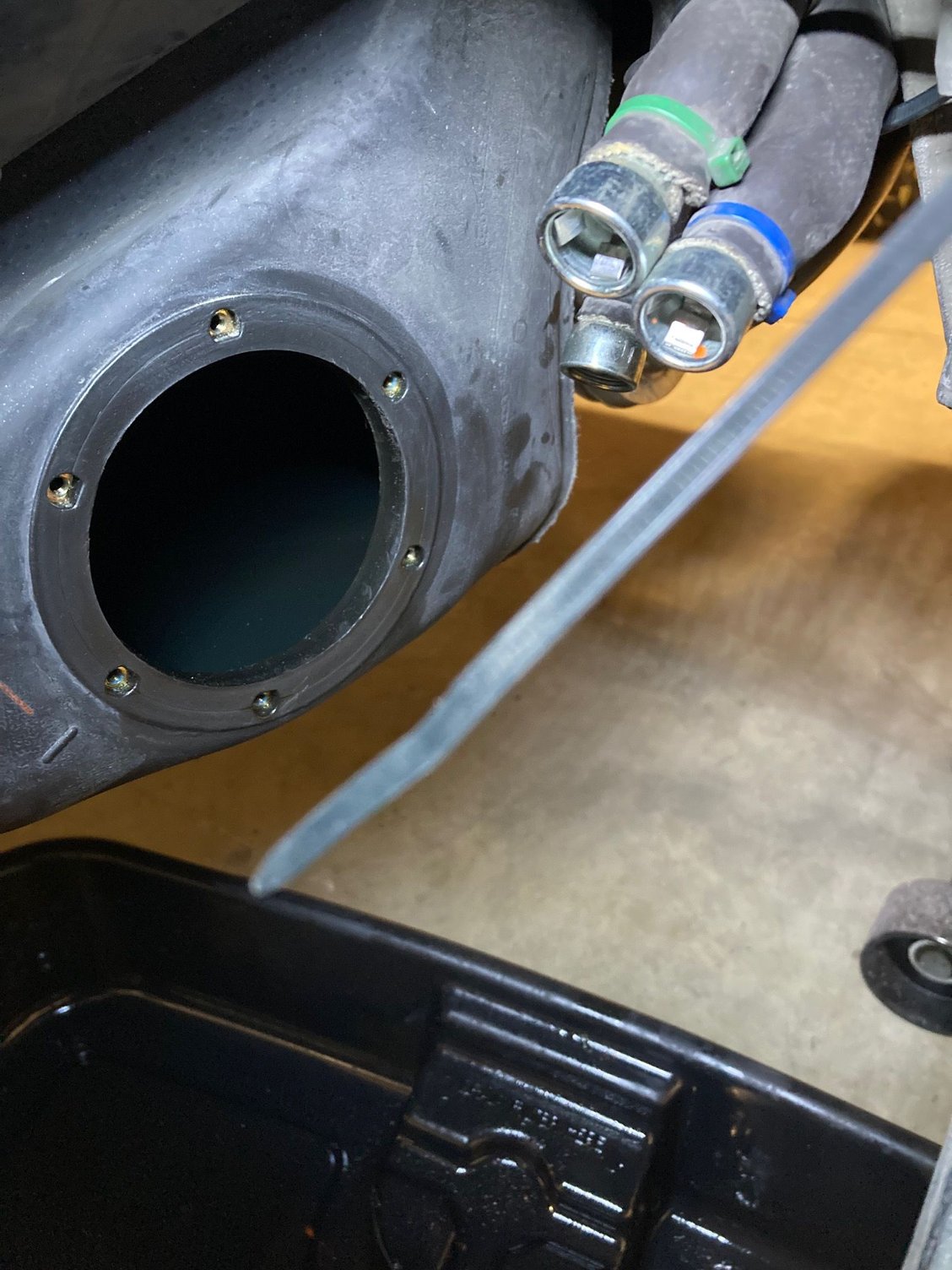

EVERYONE should have an extinguisher in their home, AND garage!! I have an extinguisher in my garage. .... But an extinguisher has resided in any garage I've owned ever since.
grinder, not trying to be a topper, but I totaled my previous house working on the fuel system on my Ducati... preaching to the choir here! I would only add to make sure to buy a big one. The extinguisher I had on hand that day was not nearly big enough. Thanks be to God no one was injured.
Anyway... halfway through the task. Hopefully the hard half. Struggled over an hour to get the three fuel lines off.
More to follow.
PS... the only fuel that came out was in the pump housing, so driving it down to less than 30 miles RANGE (on the CID) remaining is HIGHLY recommended !!

Wow... haven't seen this since I bought the car!
Totally worth it!

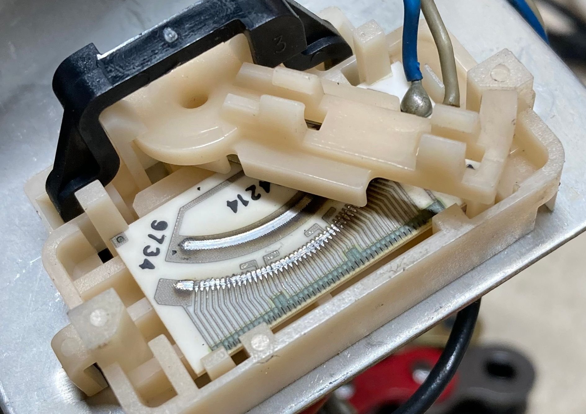

How do the senders look?
Looked like there were bits of silver missing in the FULL area. Maybe just crap on top... dunno.
Looks like spring loaded feelers that ride that range of travel. Smart guys at GM. Sometimes!

I'm guessing a stiff toothbrush would work well for cleaning the senders, too...
Here's a closeup of the sending unit. On second glance, it looks pretty good at the FULL end, unless those segments are meant to be connected:

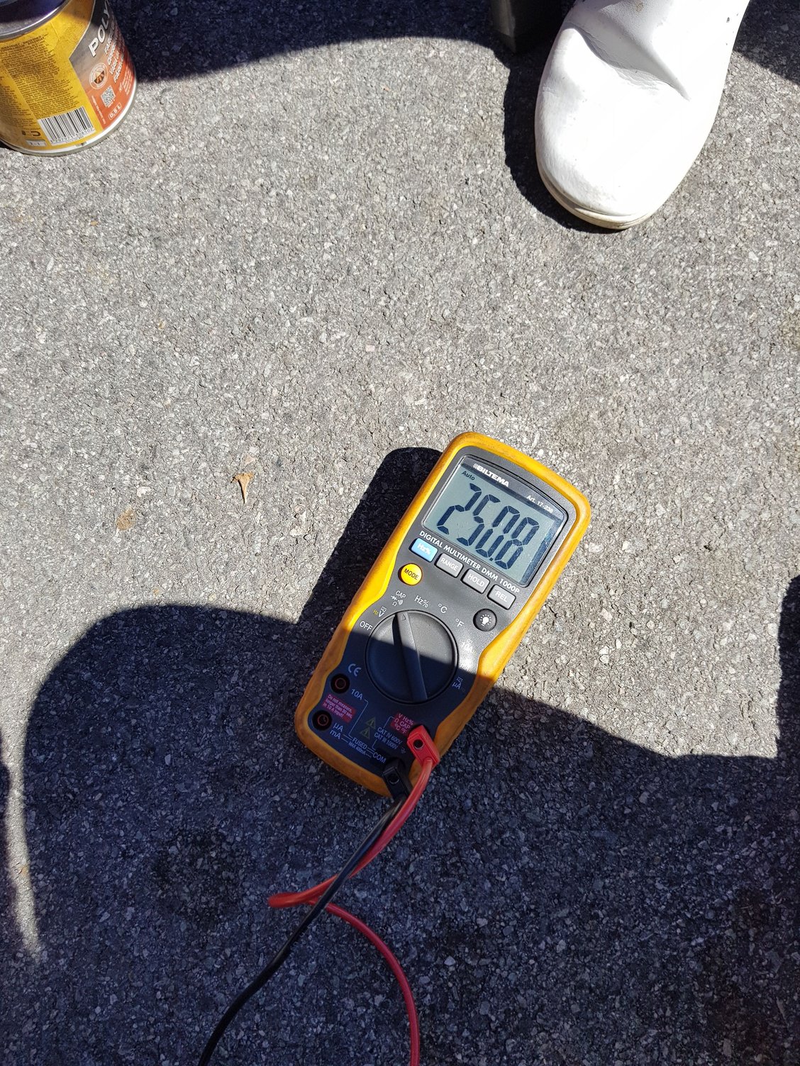

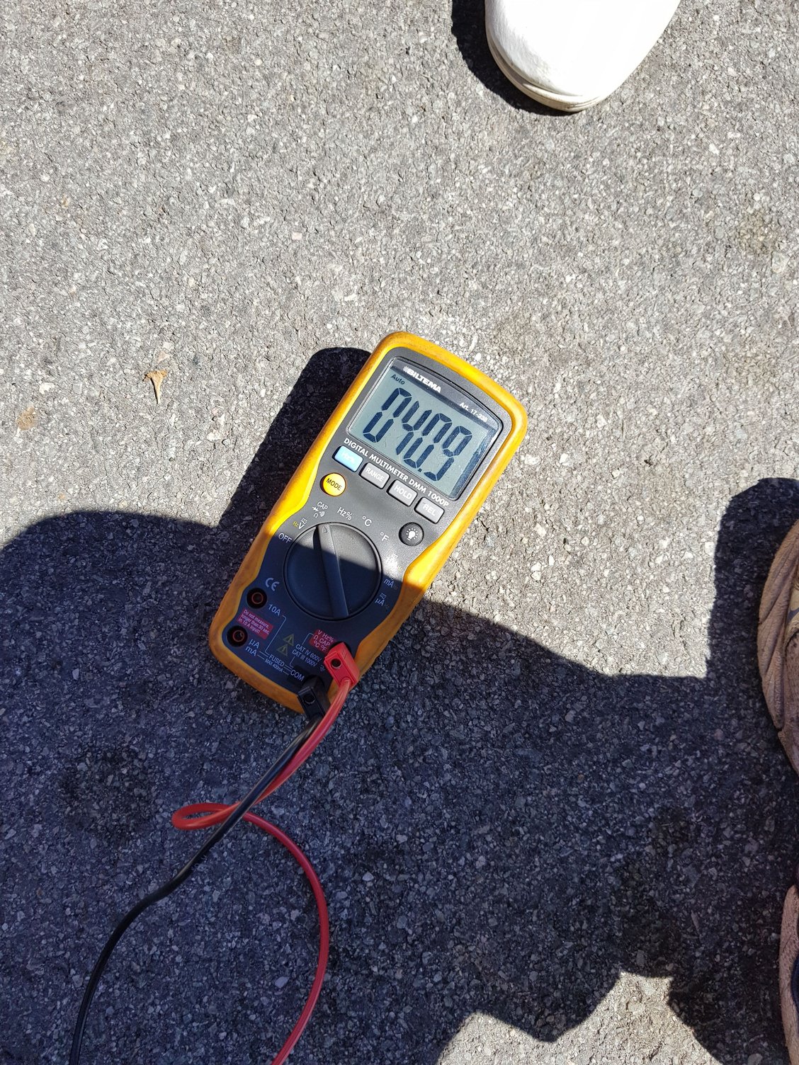

You can verify the quality of the sender slipring by measuring the resistance with a DVOM while moving the flotar all the way in a slow speed . The value should move slowly from 40 ohm to 250 ohm with no drop out of the resistance reading

I think, but am not certain, that the contacts are NOT supposed to be joined/connected. Maybe like a brush equipped electric motor, where the commutator has individual segments, which are separate. I'm pretty sure they're supposed to be individual contacts. Again, I could be wrong. Perhaps one of our electronic guru's, like C5Diag, or Bill Curlee will step in and make me look stupid!!!...
You're on to something, grinder. You can see the individual circuits coming off each segment. Probably the contact between them IS the failure...
Just out of curiosity, I'll check this out tomorrow oelarse... then it's going into the trash!
The fuel sender is a reostat or variable resistor. There is a wiper that contacts the fingers and completes the circuit. Those fingers should not be connected to each other. Looks like they just wore down and the metal migrated between the contacts causing them to be shorted together.
