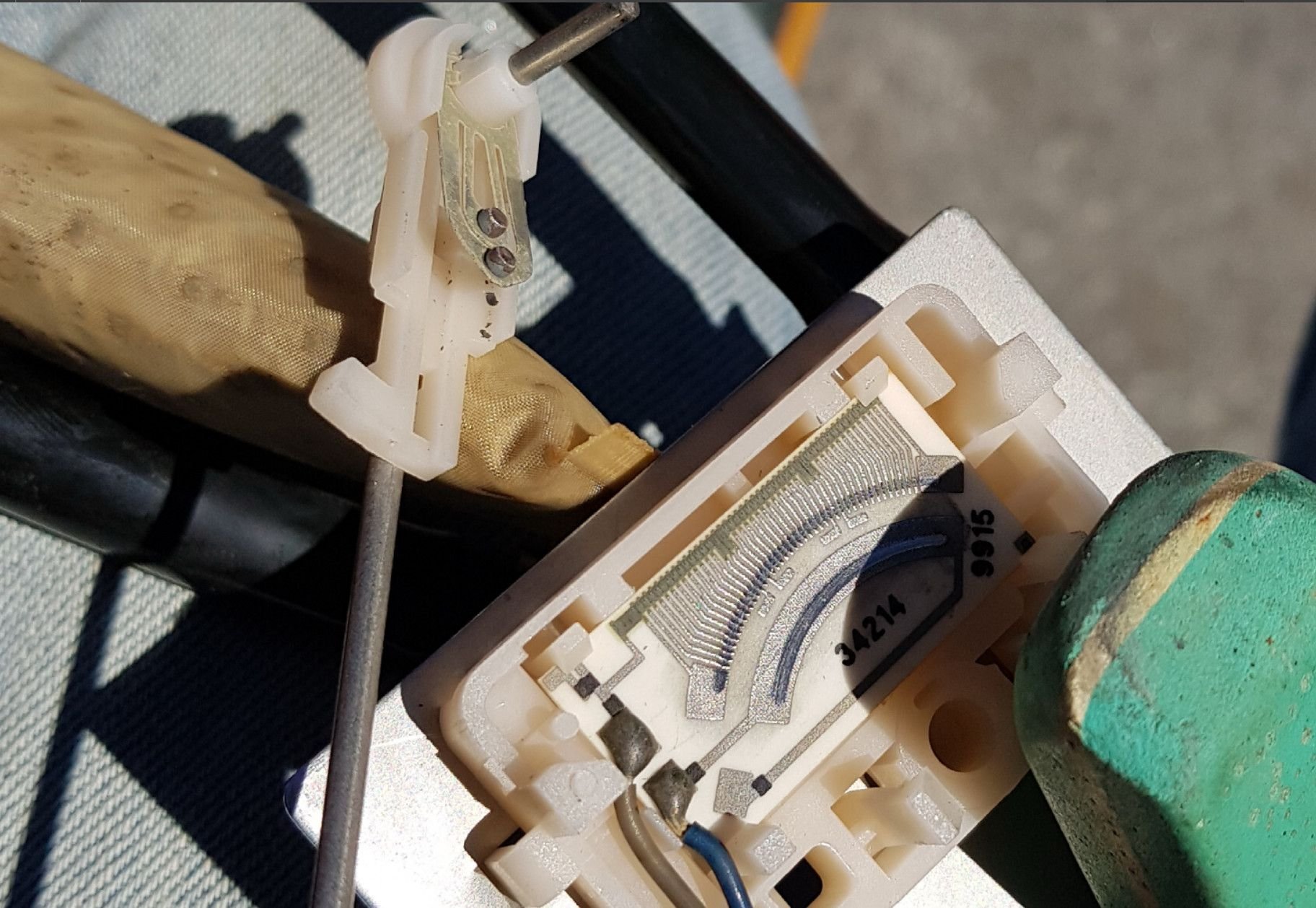

The sender is easy to take apart and I cleaned the sender slipring contact with an eraser and verified resistance value prior to installing the sender back in the tank .
If the resistance value changes in a stable way when testing outside the tank it should provide proper voltages values to the PCM when installed in the tank covered by fuel .
The tension in moving slipringcontacts should be verified prior to reinstallation

Originally Posted by oelarse
The sender is easy to take apart and I cleaned the sender slipring contact with an eraser and verified resistance value prior to installing the sender back in the tank .If the resistance value changes in a stable way when testing outside the tank it should provide proper voltages values to the PCM when installed in the tank covered by fuel .The tension in moving slipringcontacts should be verified prior to reinstallation
That is a really nice picture of the sender. Looks.like it is just solder flow. No wonder why it wears down and can migrate between the traces. You can see where it is starting to wear down.

It's most likely silver or nickel with silver solder. Copper and tin / lead solder would be too soft. At any rate, looking at these pictures and comparing to the pictures RockAuto has, it looks like the GM 19421094 part might be a different design b/c the outer band doesn't appear to be segmented like these user pics. I just ordered a pair, will report back when they show up. This might indicate GM did redesign these later on, and could be a permanent fix to this problem.

Definitely a slightly different design, but I'm not feeling like this is a magic bullet. The outer band is still segmented. Material looks to be similar in composition to the other pics. The only difference is the shape of the resistor network that's encapsulated behind the black material.
Edit: Well fornicate me. Seems the forum software makes it impossible to embed the original image. Click the link below to see full resolution of above. I hate this forum (software).
Full Resolution Image

See pic below. Mr. Black put these part #s up back in posts #14 and #16.
One thing I noticed after posting the previous image is that the contacting portion of the wipers on this part are less "robust" than the ones of the presumably older units further back in this thread.
Click here to see a full resolution image.
Totally agree, this does not look nearly as robust as the original style.

Edit: BTW, I finally read the (very poorly printed) installation instructions that came with these senders, and notice this kit appears to be related to a TSB. Here's the first couple lines:
Application: Corvette Model Years 1997 through 2000
Purpose of Kit:
This procedure is to be used when servicing the level unit assembly for the applications noted. The purpose of this kit is to address a potential float arm sticking condition found in isolated cases.
I think this means the less "robust" wiper fingers were designed to reduce the likelihood of the segmented contact points getting "smeared" as was depicted in post #53.
