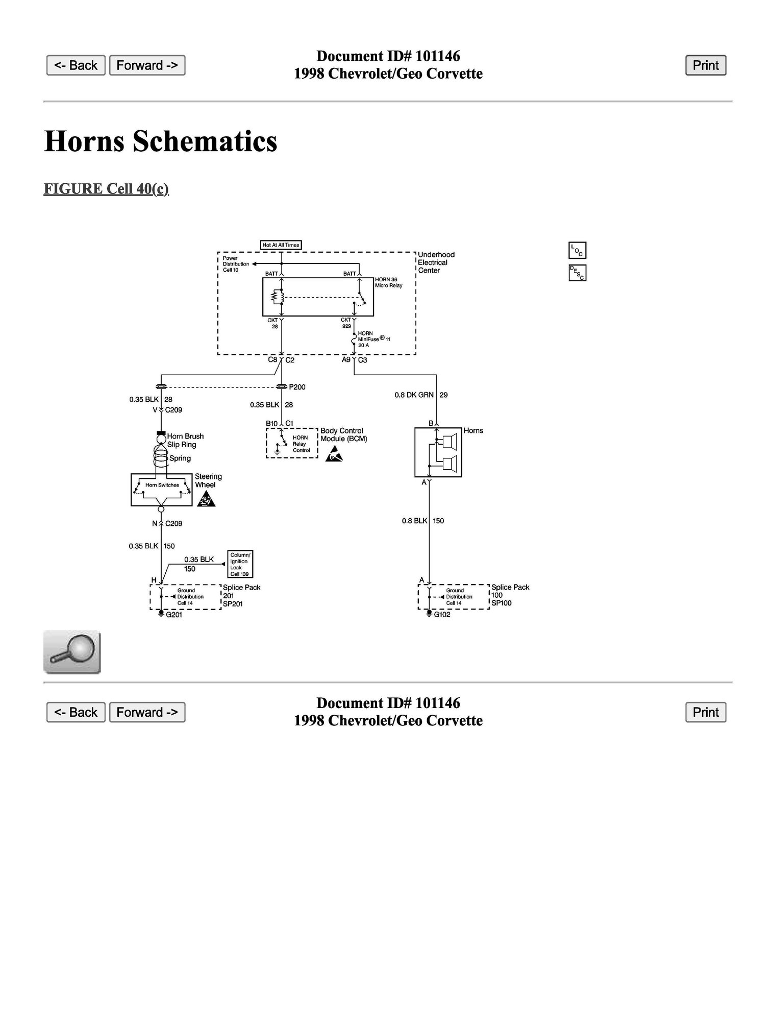

The horn fuse has nothing to do with the relay operation One side of the relay coil is hot at all times, and the other side is provided a ground via the horn membrane switch. Just because a relay is clicking, does not mean that the contacts are functioning. Put the horn fuse back in, and check for 12volts at the fuse when you press the steering wheel. Test light works perfect in this situation.

You must mean voltage and not "current"...2 separate things...the first thing is to check that you have a good ground...if all available current is not dropped across the horn circuit it will not operate...I can't remember how many amps the horn draws but it may be somewhere around 2-3 possibly...you always load a ground dynamically with the expected amperage in the circuit...NOT RESISTANCE CHECKS...I would get yourself a 50 watt headlight bulb and connect it between the 2 connector wires...press the horn and if the light is bright the ground is good...if the ground is good the horn is most likely bad.

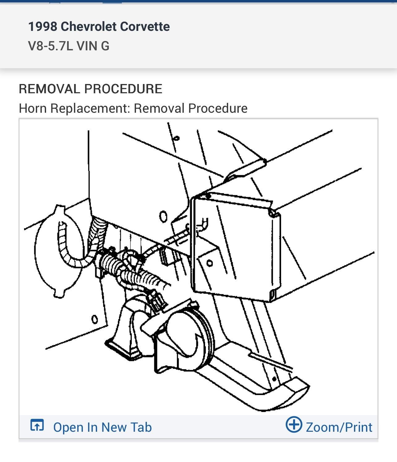

Remind me where the horn(s) are located... ahead of the right front tire?

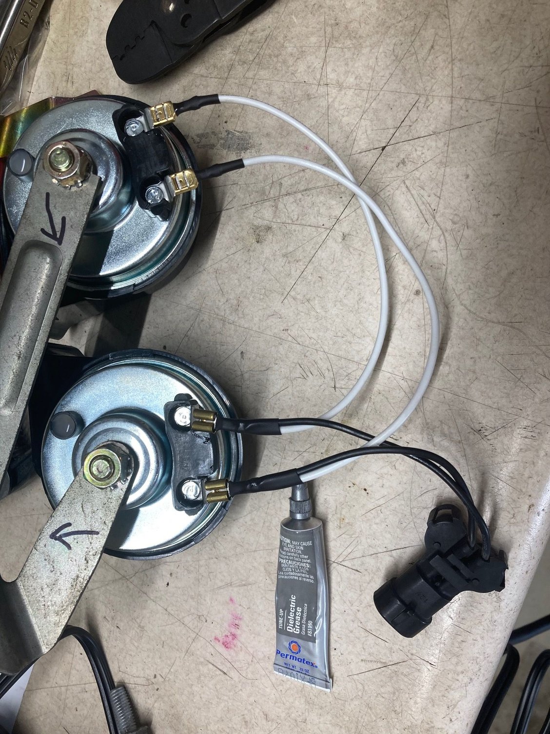

Final update: Bought High/Low horns from AC Delco and I've got normal horn function back! Finally! I'm guessing one horn failed years ago and the second one went as the membrane switch failed. Neither original horn would sound off when connected directly to the battery, just to confirm they were both bad. Had to splice in the original connector:

Hopefully you did not use the dielectric grease in the connector.

Nope, just on the horn connections. All good!
