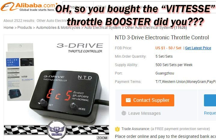

I never mind competition... in fact I welcome it and I strongly encourage people to drive cars with either mods before buying because
anyone that tries both.... will go with me,.
In this world of people wanting instant gratification or don't mind buying cheaply made products if they can get them quicker, that's
just how the world works now a days.
The CoW BOOSTER! still retains the title of the " Most AMAZING C6 product ever offered " and is the most popular product we sell to date.
When there are 2 gas stations on opposite sides of the street, or McDonald's on one corner and Burger King on the other.... regardless of which is
"better" each usually nets the same # of customers.... just simply because they are across the street and you get some people coming and you
get others....going.... The problem is when you buy REALLY CHEAP products.... and you pay full price.... Cause you don't know any better....
That's where problem lies..... And YES, you get what you pay for.....
When you pay $200 for something that only costs $1..... It's gotta make you think...
