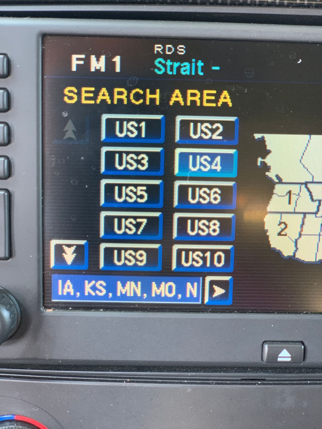

Got the disks, put the nav disk first waited as per instructions from FACADE and low and behold When it first appeared on the screen the clock did not appear then 5 seconds later bam it was there then put in the updated nav disk and had all the regions come up on the nave menu. In these times sitting in the driveway car running and no place to go, It put a smile on my face. Thank-You FACADE for sending those disks to me. And to JOHN ROW we have the same year and color car and seems the same problem
