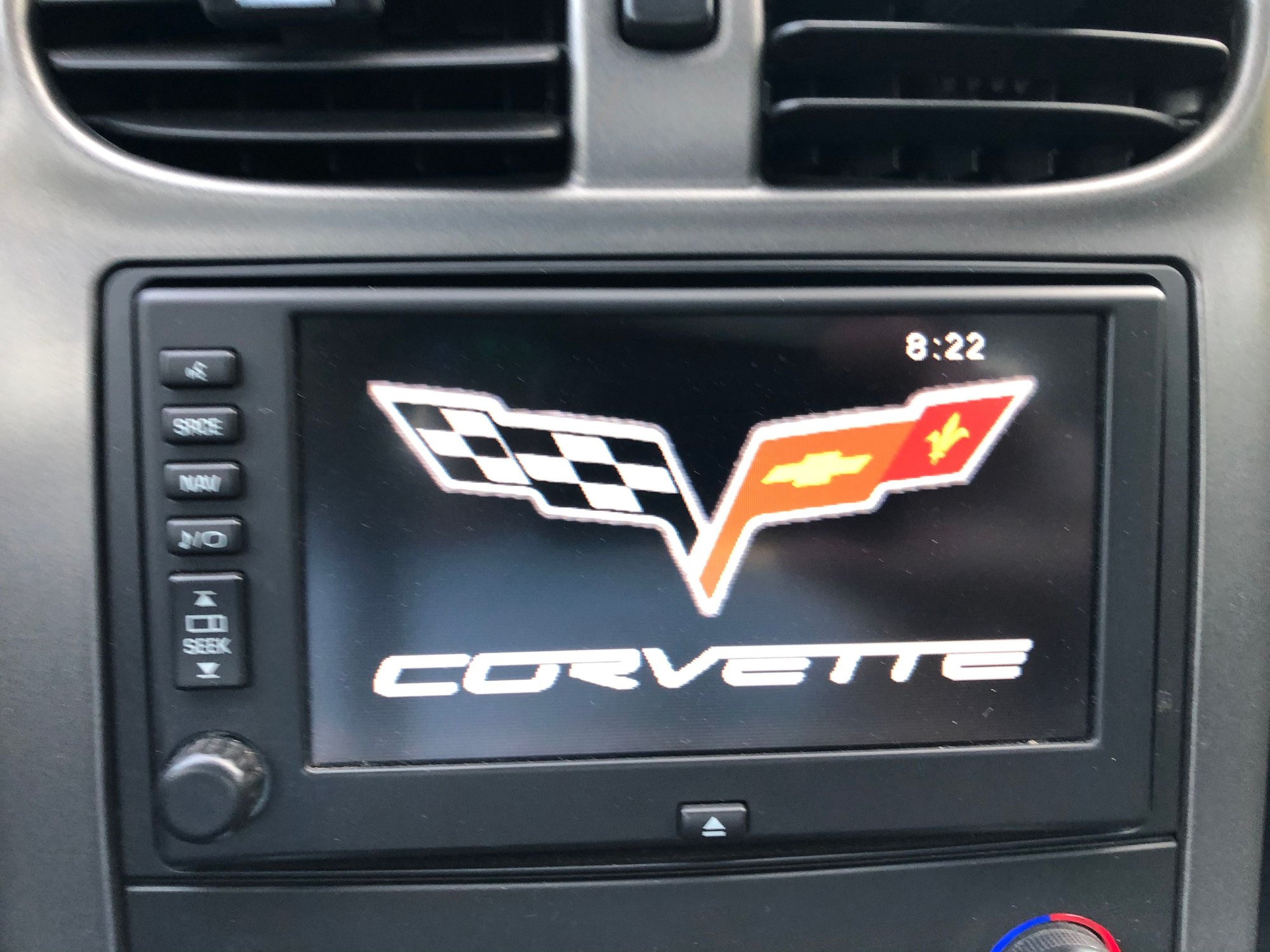

Default Self fixed!
I couldn’t believe my eyes early this morning. I almost went off the road upon glancing over at the Nav center and saw the clock working! Huh! I didn’t download the patch or do anything to make it work. Only short commute drives into town 5 miles. Go figure this one out! Any who...was super happy to see it up on the off screen. When I got home I went to the clock adjustment screen to select 12 hr mode vs the 24 hr mode it was currently in. I was a bit hesitant at first to touch it. You know the old saying...” If it ain’t broke don’t fix it”! Well I took my chance, holding my breath and fingers crossed and selected 12 hr mode. BINGO! It still works. Sigh. Do you think that perhaps GM put in a patch FINALLY?!?! Anyways, I hope all of your clocks that aren’t working on your nav center starts working mysteriously like mine did on my 06 Z51. Cheers!
proof or it didn’t happen right! Here’s a screenshot!
Clock magically started working this morning while driving.

When you click on the time, what date do you get? If you unhook your battery, it will likely disappear again if you haven't updated the file with the CD-R
Interesting however.
I checked the clock date yesterday. It readout January 01, 2001. Which, having the correct date doesn’t matter to me. Is there a special significance to the date that appears when the clock starts working again? Just curious.
Presumably you haven't applied the firmware fix, so the NAV system can't calculate the correct date from the GPS signal. Owing to limitations in the original specification for date calculation, the date 'wraps around' at roughly 20 year intervals. We are I believe on the third wrap around. So unless, you have updated firmware, your NAV system is applying an offset which worked 20 years ago, but not now. If you apply the firmware patch, your date should end up being correct.
