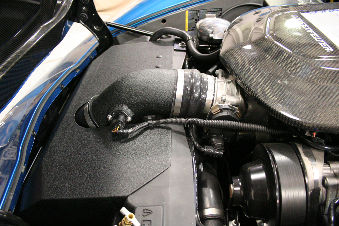

Looks like I'm not the only one using a shroud on my supercharger air intake!...my LS3
Some guy named "Lingenfelter"...application is a ZR1

Great minds think alike

Have you had an opportunity to determine if it is helping the IATs?
At the same time that I added the shroud I also opened the radiator baffle to allow more cool air to reach the intake and I changed coolant in the supercharger system to straight distilled water with a bottle of Water Wetter and I also changed back to a 160 thermostat. I haven't driven the car enough to quantify the improvement but it is better...I just can't give you a x % better. I still plan to add fans to the front of the heat exchanger before I call it quits though.
