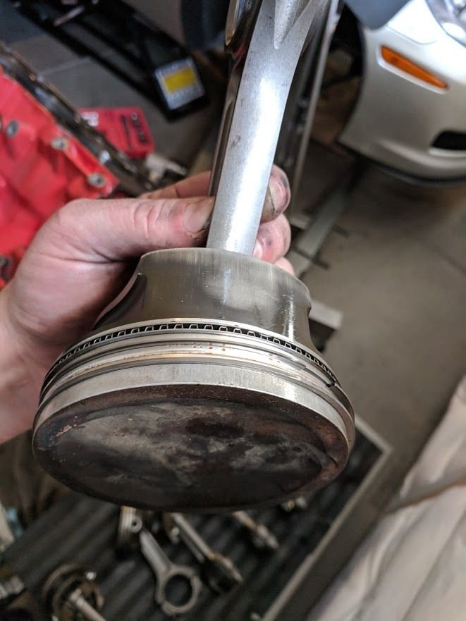

Old Mar 31, 2018 | 05:59 PM
  #102
Innovate's Avatar
Innovate
Posts: 1,931
Likes: 207
From: Sumter SC

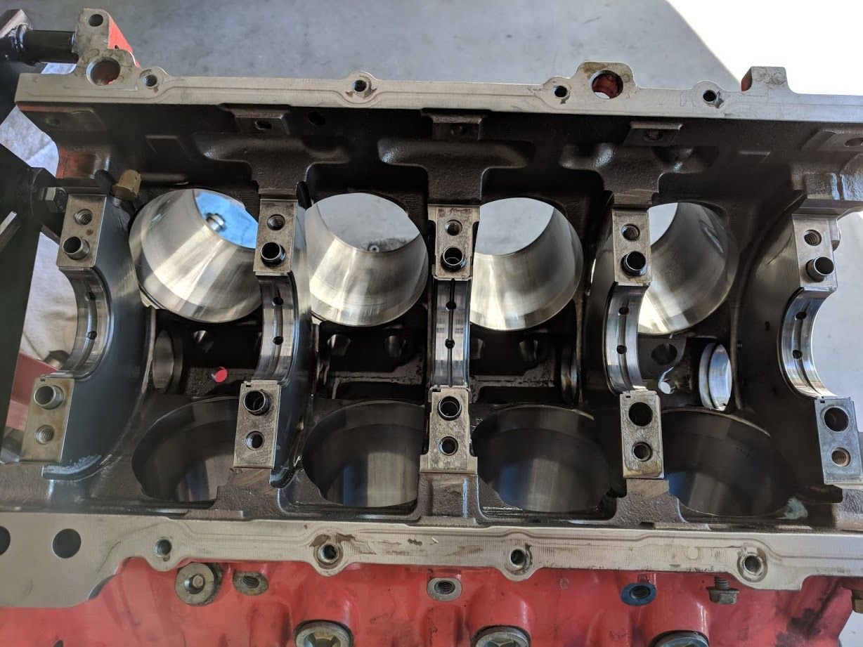

Eeek, that piston does not look good. Have you thought about an RHS block? Tick Performance has them for $4,700ish. Those are some expensive engine blocks though.
Old Mar 31, 2018 | 06:11 PM
  #103
Unreal's Avatar
Unreal
Joined: Nov 2007
Posts: 24,035
Likes: 2,342
From: Gilbert AZ
That piston is fine. It looks great in fact. It was to show the coating on skirt is barely worn through and skirt isn't worn or trashed .
Rhs blocks are complete crap. If I wanted a piece of crap my dog deposits plenty in the backyard. Just ask Bret how well rhs blocks work. They are hands down the worst ls blocks our there.

Ah ok, I thought the piston was burnt or something until you said coating and I looked at the piston again.
Bret who? There is a Brett in NC with a 427 RHS motor in a C6 GS and he makes 1,200 rwhp. I really do not know much about them and I have not heard really bad things about them. My research on them did start today though.
Old Mar 31, 2018 | 08:05 PM
  #106
Unreal's Avatar
Unreal
Joined: Nov 2007
Posts: 24,035
Likes: 2,342
From: Gilbert AZ
Bret b. Split one in half first pull.
  #107
Innovate's Avatar
Innovate
Posts: 1,931
Likes: 207
From: Sumter SC

Old Mar 31, 2018 | 08:06 PM
  #108
Innovate's Avatar
Innovate
Posts: 1,931
Likes: 207
From: Sumter SC
Holy jeez, yep I would be saying next as well.

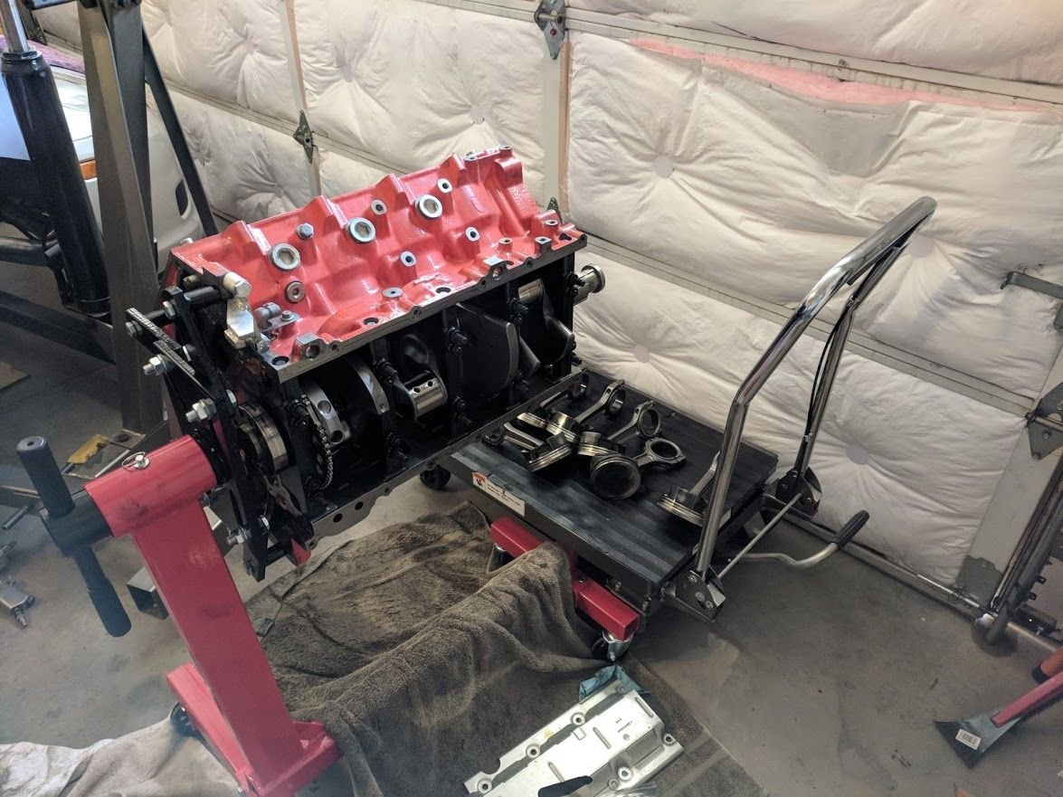

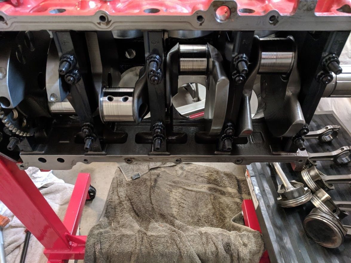

Old Apr 1, 2018 | 11:30 PM
  #110
Garmans12valve's Avatar
Garmans12valve
Joined: May 2014
Posts: 117
Likes: 7
From: GreatFalls Mt

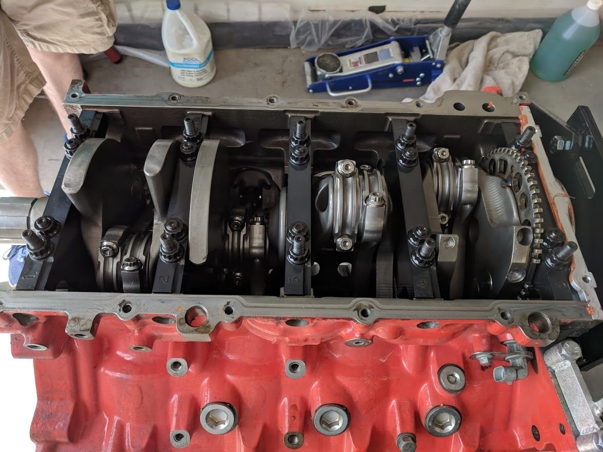

What was the condition of all the rod and main bearings?
Great. No issues.
Old Apr 2, 2018 | 08:52 AM
  #112
Quiky One's Avatar
Quiky One
Joined: Feb 2008
Posts: 681
Likes: 65
What did you clearance your mains to?

Ask Livernois who built the motor. I have no idea. I know it ran great, had solid oil pressure. ~60-70psi cold, ~45psi or so hot at idle.

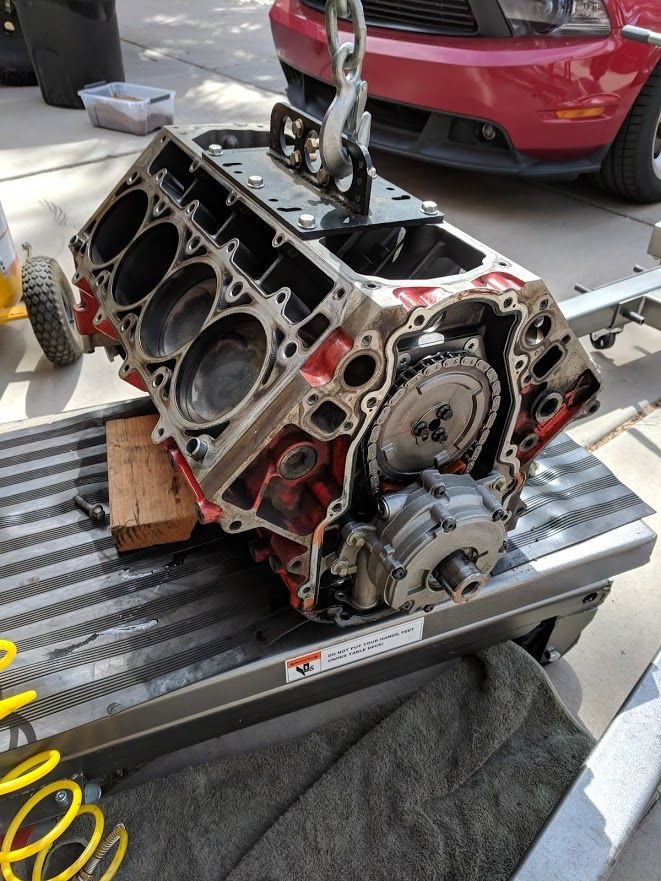

Old Apr 2, 2018 | 11:35 AM
  #115
Turbo-Geist's Avatar
Turbo-Geist
Joined: Jul 2008
Posts: 3,002
Likes: 216
From: Houston Texas
2017 C5 of Year Finalist
Any pictures of the head gasket failure?
Have you determined if the block cracked?
Old Apr 2, 2018 | 11:59 AM
  #116
Unreal's Avatar
Unreal
Joined: Nov 2007
Posts: 24,035
Likes: 2,342
From: Gilbert AZ
I could dig it out of the trash
Block is fine. Just a ding from piston ring.
Old Apr 2, 2018 | 02:52 PM
  #117
MTPZ06's Avatar
MTPZ06
Joined: Dec 2008
Posts: 35,874
Likes: 1,600
From: Honolulu HI
Bottom end looks healthy.
