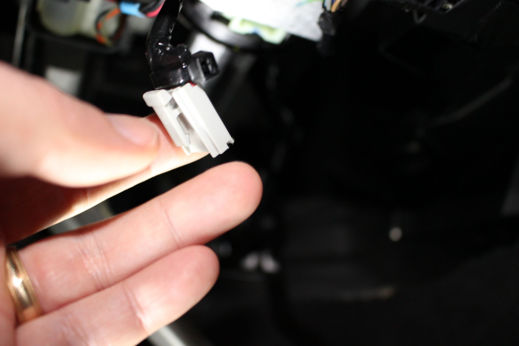

Can you tell me where the connection is located so I can unplug? Every time I move the steering wheel
in or out I get the message. I recall taking it in for the quick fix, but I still have the problem. Thanks.
Old Dec 15, 2019 | 04:41 PM
  #899
1972bluelt1's Avatar
1972bluelt1
Joined: Jun 2009
Posts: 1,135
Likes: 226
From: Roanoke Indiana
You'll have to remove the panel under the dash. It's on the bottom of the steering column.
1972bluelt1
Joined: Jun 2009
Posts: 1,135
Likes: 226
I think that tape and tywrap are GMs high tech fix from a recall before I owned the car.
