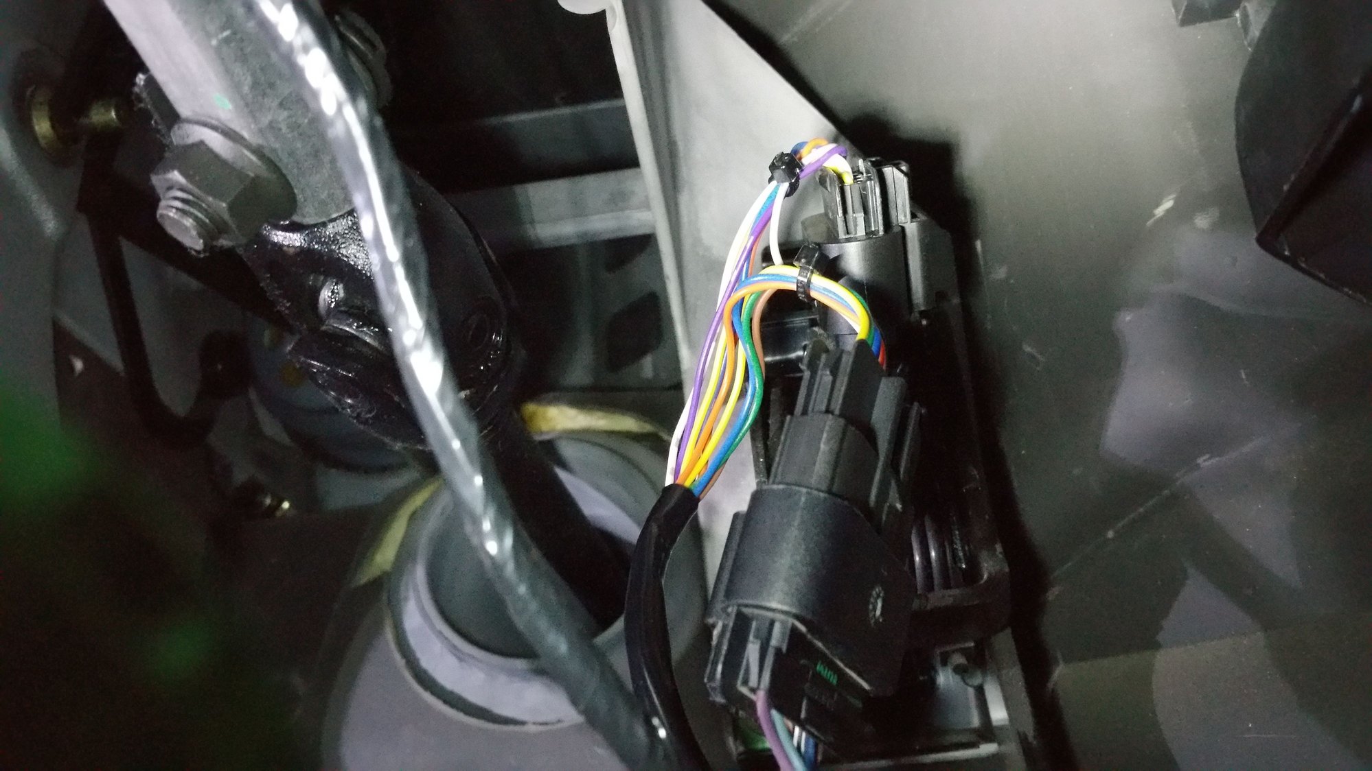

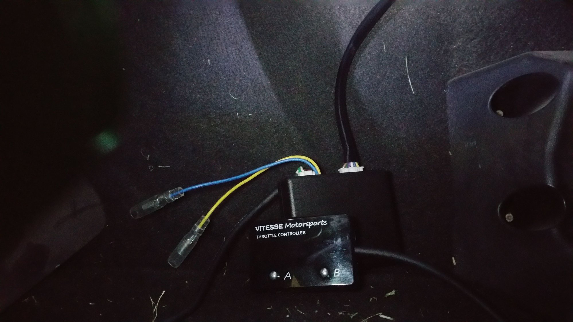

It is like the car is not recognizing it, or blocking it from working. Instructions were followed exactly. As soon as I plug the stock harness back in, all is well. Plug this in and nothing.
Both harnesses connected
No power on the controller with all connected
With car in the On position, this is the message on the display

looks like you will have to make the call at the bottom of the instructions

Not sure if this is part of your problem but the vehicle needs to be in ignition on position, not accy. To do this on push to start c6, you have to hold down the bottom of the switch for about 6 + seconds (like you're putting in accy but longer).
I would disconnect everything, run the vehicle some as normal, then follow the Vitesse set up EXACTLY. If still issues I would disconnect the battery for a couple minutes, then drive, then try again with install.

Yea, I had to put mine in ACCY mode and I was able to program it. Push down on the Start button for a few seconds, then follow the instructions. I agree that the instructions are unclear for our cars due to the way the ignition switch works. Mine showed accy mode in the DIC so I guess you can program it in either mode.
