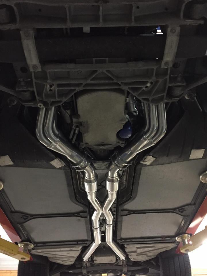

This weekend I had Kooks 1 7/8 long-tube headers, catted x-pipe, and Elite Engineering insulated tunnel plate installed on my 2012 Grand Sport with auto. These are my initial observations after about 150 miles of driving.
1. More power - I have a canned SCT tune installed. I selected the long-tube headers setting. Although not a dead on tune, the car runs good and throws no codes. I'll get a dyno tune later, but don't feel an urgent need. The car runs a lot more like a Corvette should!
2. Less console heat - I had the headers and x-pipe ceramic coated. Combined with the insulated tunnel plate, there's a noticeable decrease in how hot the console gets. Admittedly, I haven't driven in really hot weather yet.
3. The car feels lighter - I'm not just talking about at speed. Even at low speed when I'm not using the extra power, the car feels lighter. I think it's because of the modest decrease in weight from the exhaust (maybe 20 pounds) and the modest stiffening caused by the thicker tunnel plate.
4. The car isn't very much louder most of the time - My car has NPP. At idle and at highway/freeway speeds it's not much louder at all, if any. It barks when the dual-mode is opened up, though. It also has a deeper idle note, a lot like a C6 Z06. In my opinion, this is just about an ideal exhaust setup.
5. The installation was very straightforward - The fit and finish of everything was top-shelf. There was no drama to the installation at all.
Needless to say, I'm pleased with the results.
