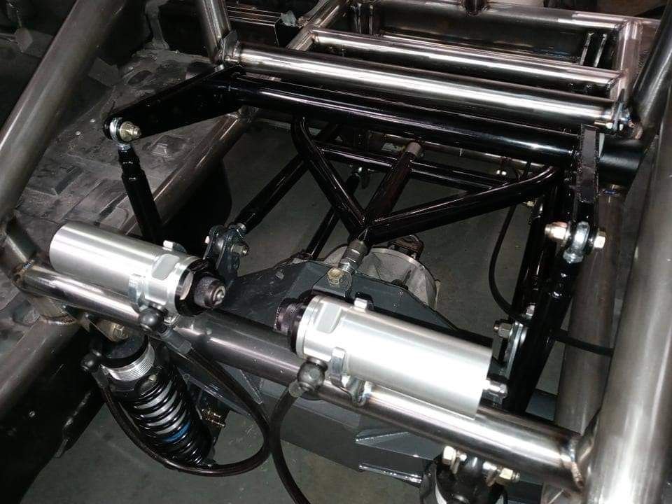

Not sure How I missed this thread. I ordered parts in October, received them end of March. Here's where I sit (kinda bursted my bubble seeing those red 4Link bars in that other pic).

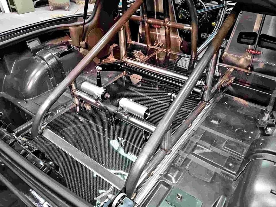

How did the Rhodes cage fit after all? Minimal or no modifications?
Do you have pics of how you mounted everything in the rear?

The main hoop, rear down bars, door bars, etc fit well as most of them are left long and you trim to fit. The pre bent roof halo is a bit lower than I would like, if I were to do it again I would probably make that part myself to tuck it up better.
I just helped with another car get 4 linked and it came out even better than mine since mine was an experiment per say to see if it would even work. I have half an itch to redo it all this winter.
dang, do you have pics of how low it is? I wanted to use the same one but def need it to go up as close to the roof line as i can get it.
The main hoop is up against the body and the halo is touching the A pillar and roof, just some custom made bars bend the bar up to follow the contour of the head liner for more head space which is nicer. But for $350 or whatever it is I aint mad at it, its solid AF.

you are going to want to move that wishbone to the top.

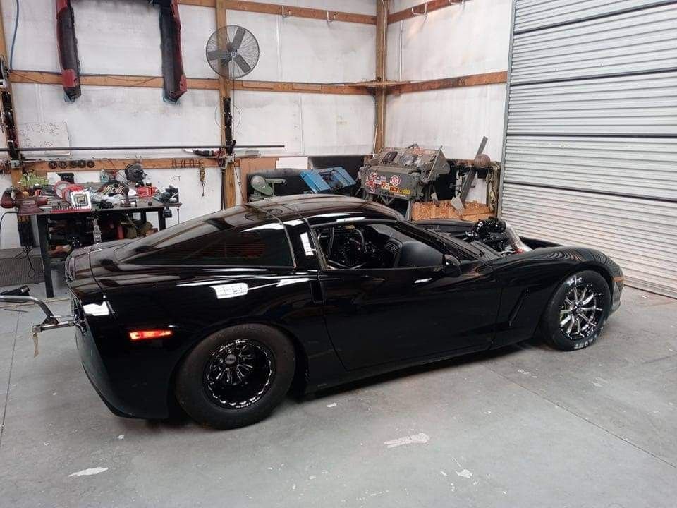

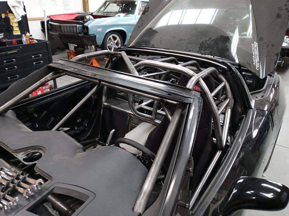

Some pictures for y’all.
sick build, my biggest issue is i have a Z06 the frame is aluminum. I was thinking about doing subframe supports with a cage. I think if I box the rear aluminum frame with 10g aluminum plate then make a steel box to bolt into the aluminum frame to tie the 4 link into it should be strong enough.
Sweet, dig the carbon finish work!! I'm glad I stumbled on some pics of guys like you who had done it before jumping in. The C6 drivetrain just sucks when you try to put power down so it was either time for a project like this or time to sell it.
