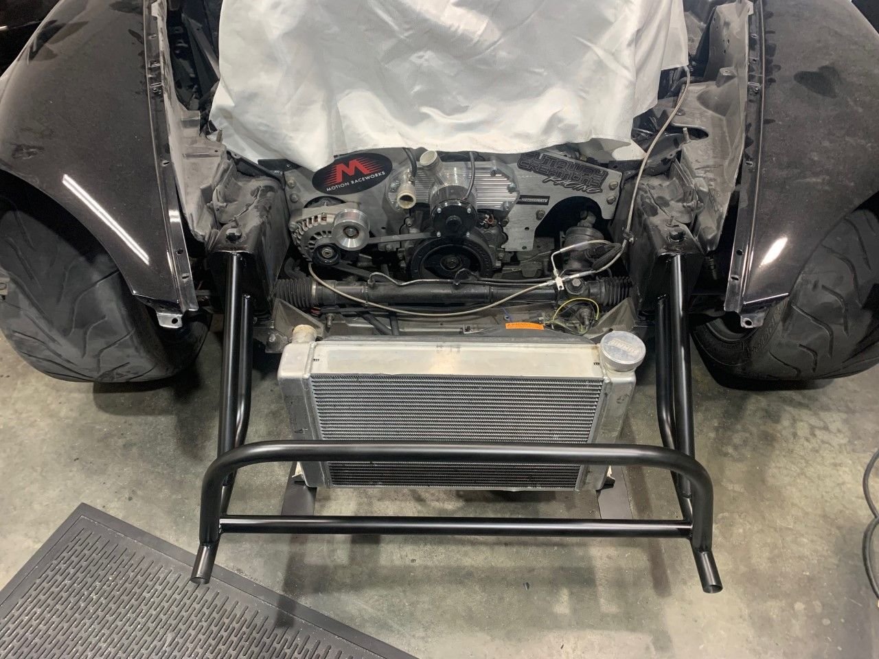

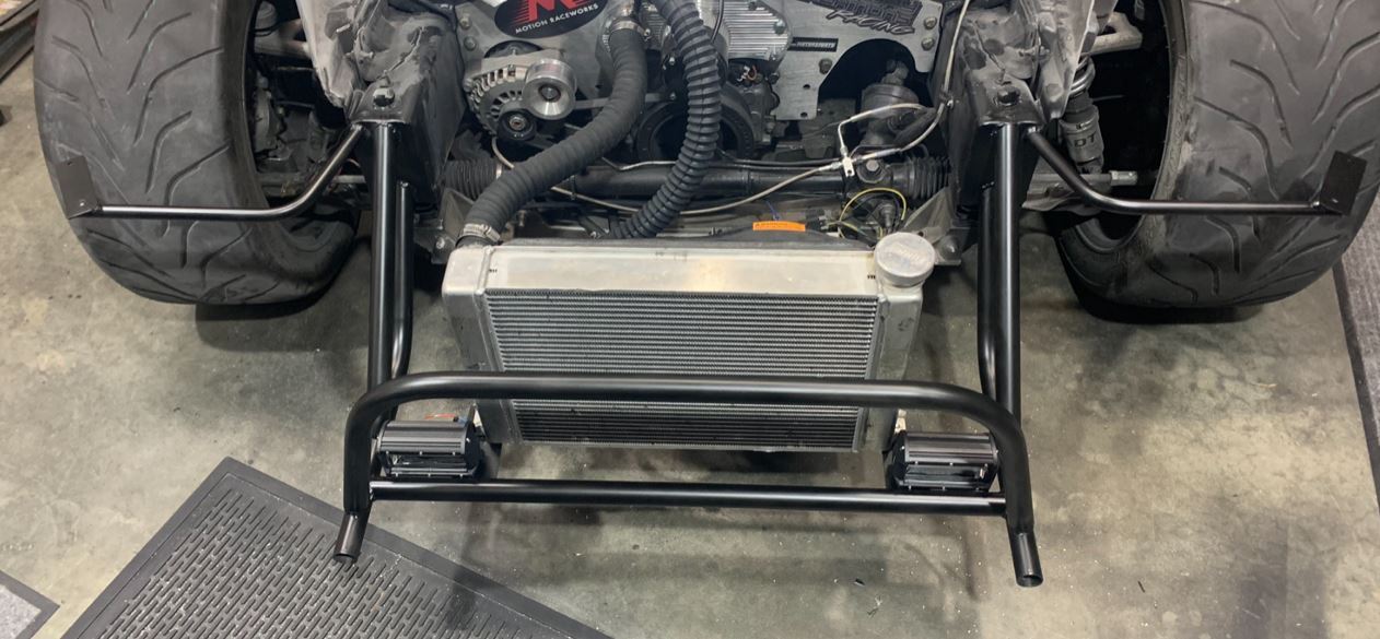

Finally got around to giving the front end some love. Swapped in longer 200lb springs and worked on dropping weight. Dropped about 100lbs between the Strange 4 piston drag brakes and two piece rotors, deleting headlights (used replacement lenses painted black to fill the holes), and fabbed up a .083 wall 1.25" chromoly tube front end, fender/bumper supports are .065 wall 3/4" chromoly tubing.
Front end bolts on like stock with the OEM fender/bumper brackets, bumper sits on the two nubs sticking out for extra support below the grill. LED lights shine through the lower grill and are way brighter than stock!

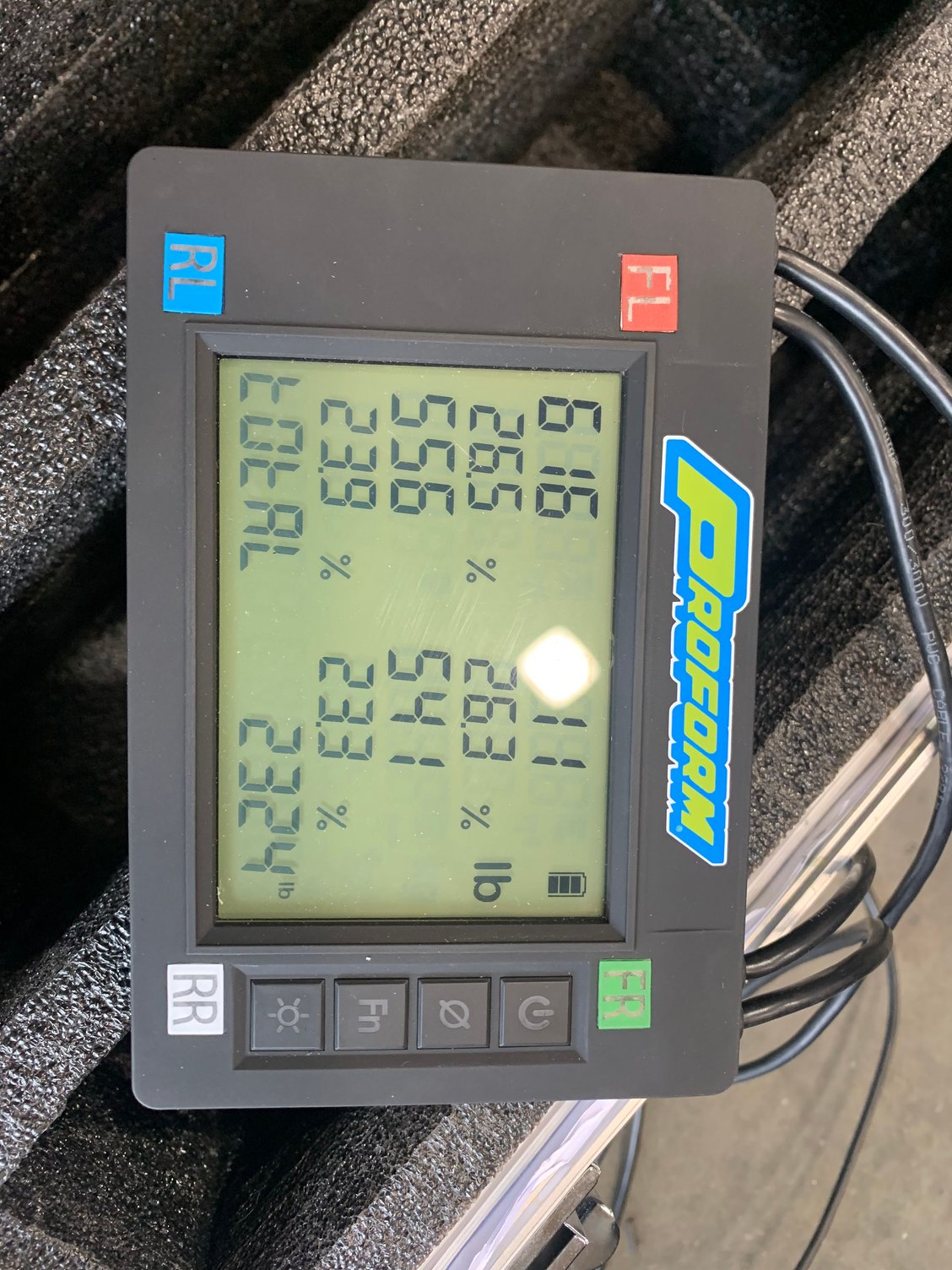

My guess on weight savings turned out to be pretty close. Car came in at 2,383 lbs with R888 street tires. Bolted on my front runners and dropped to 2,352 lbs. Then put my slicks on and final weight with full tank of fuel, skinnies and slicks is 2,324 lbs!
That gives me hope it’ll be about 2,280 lbs with a half tank. Looks like a goal of 2,1xx without the turbos is a real possibility! Weight distribution isn’t too bad either.

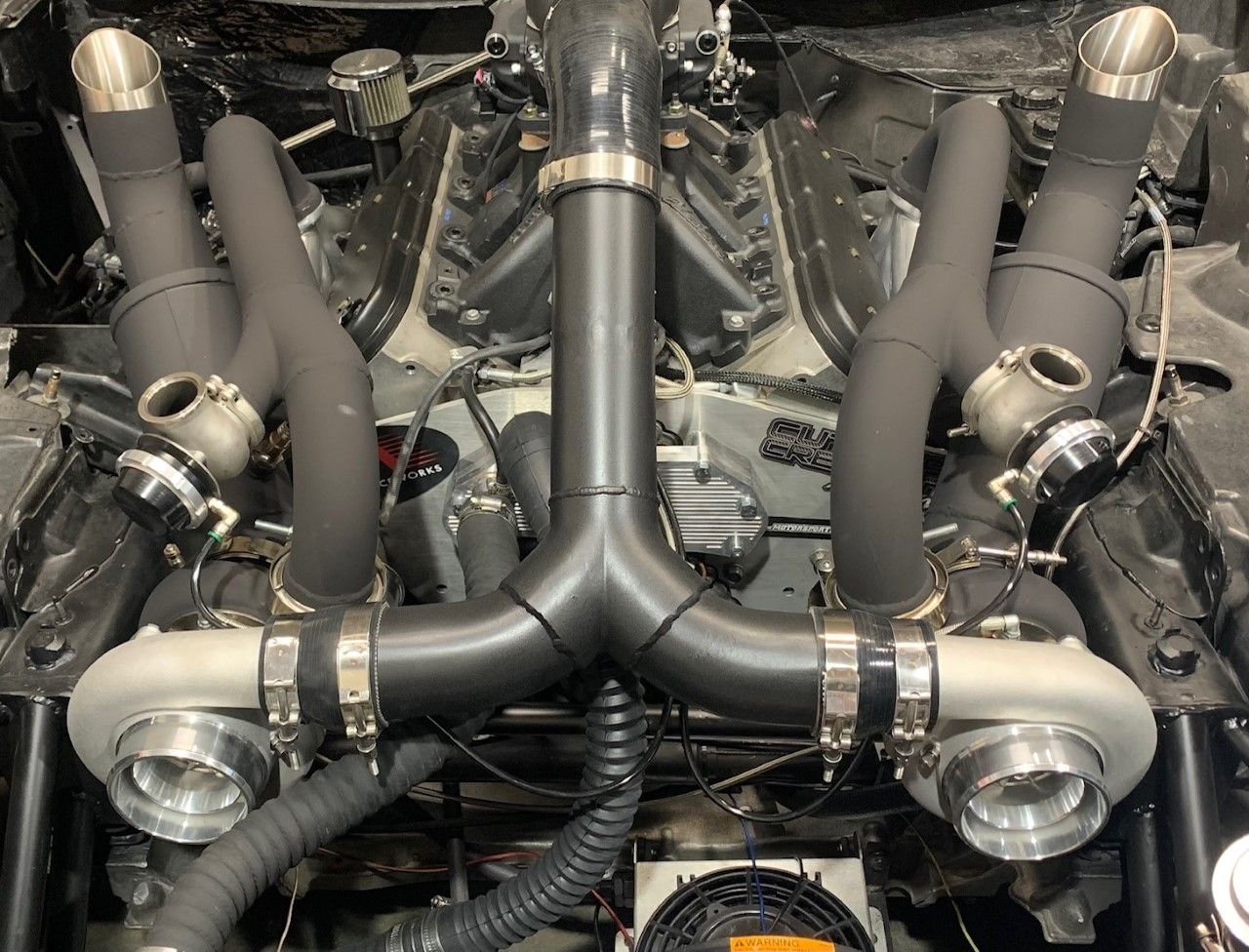

Decided to build a new turbo kit, dropped some weight off the front end in the process. Not exactly symmetrical given the offset of the heads, but close enough. Still need to clean things up, but it works.
