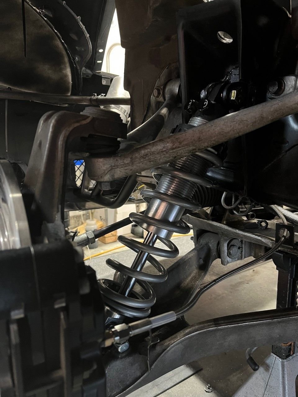

Little update! I wanted a double adjustable up front but it seemed like most if not all available options allowed the upper a arm to hit the coil spring on full droop. I know some people installed limiting straps to stop that problem, but that limits wheel travel which isn't ideal. I decided to ditch the OEM upper mount and weld on my own shock mount to the frame. Now I can use the full down travel of the suspension with plenty of clearance, using 200lb front springs and the adjustments are easy to reach.

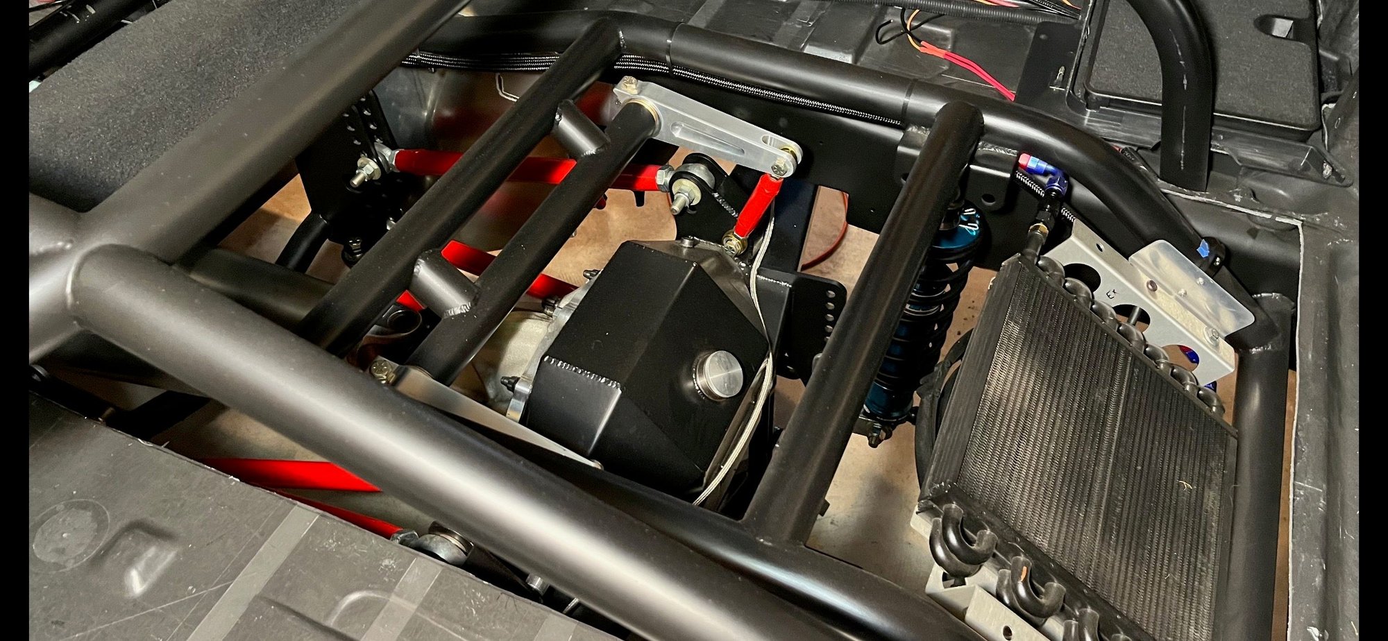

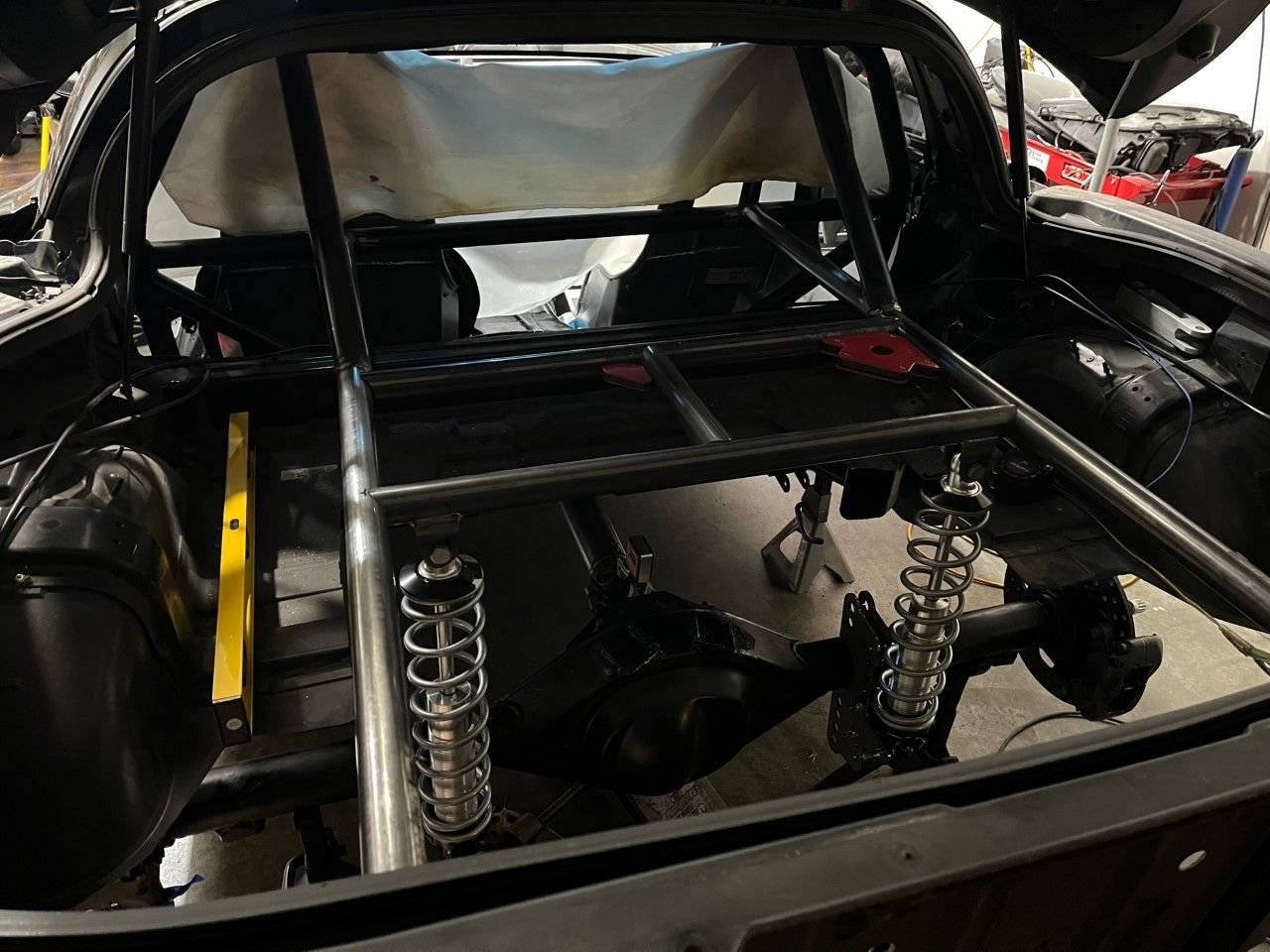

And a larger update! After two years I decided to change things up out back as well. My original 4 link setup was installed around the factory frame rails, which limited things a bit and turns out they were really eff'n heavy!! So I cut out the whole back section of the car and started over. Lots more left to go, but I think I'm off to a good start for only working on it the last 2 evenings. So much more room to work, it'll be a good bit lighter, have more wheel travel, etc...
You are a glutton for punishment!
Well its either work on this car or get another one. I cant decide what else to get so here I am.
