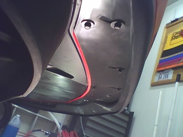

I think that almost no one installs this splitter just for improved down force. Most are installed just because they like the way it looks, and I think it does complete the front end.. However, if you really are going to race the car, you should use the screws or rivets to mount the front edge. Remember, the real purpose is to create force on the front end, and plastic fasteners may not be strong enough. I used the same bumper cover screws that GM uses to attach the rest of the bumper.
Use these and they are stronger and still can be easily removed.

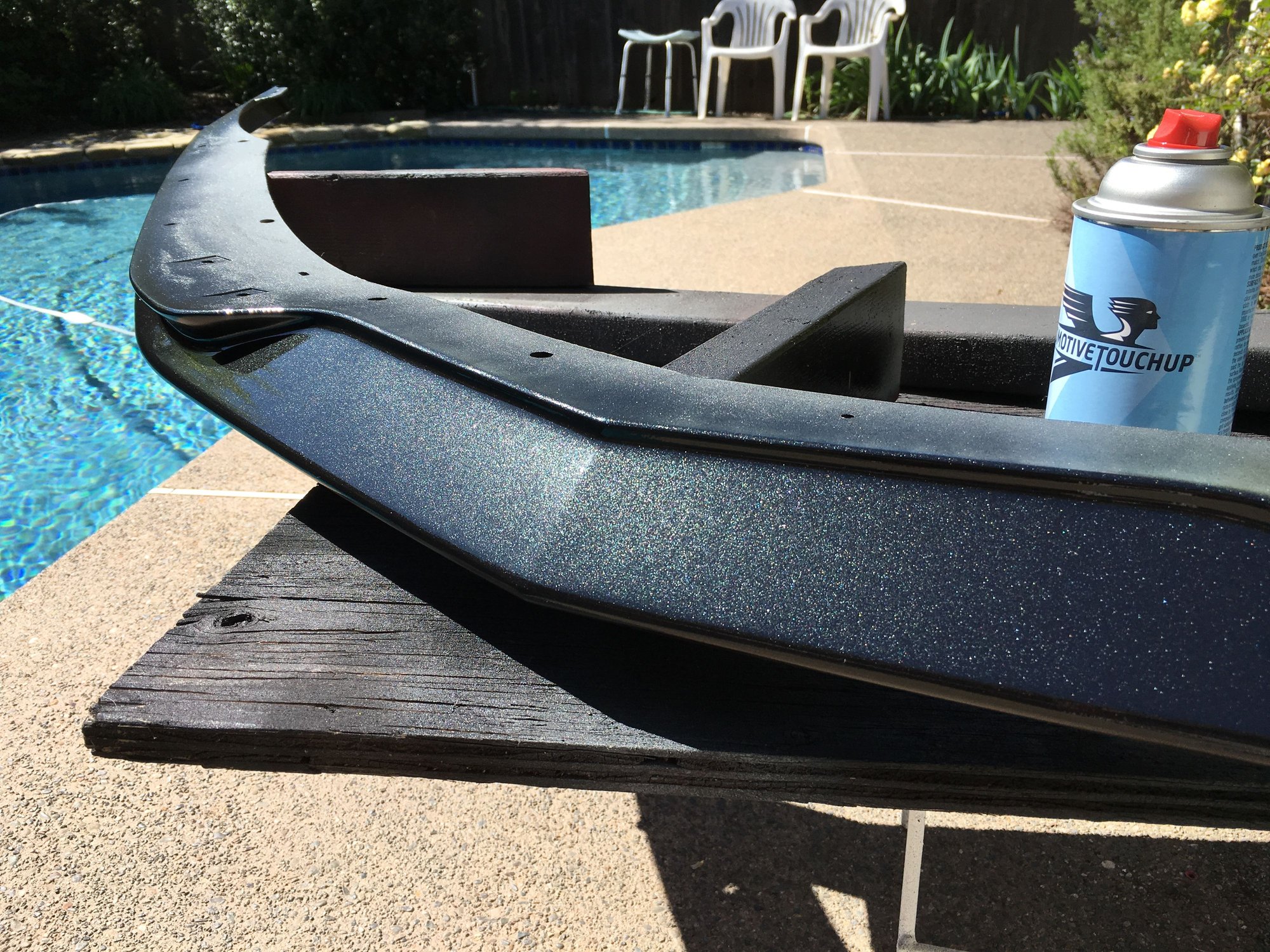

Nice, I picked one up off amazon a few weeks ago for $110 shipped. Even though it's gonna get beat up, I painted this one too. It looks so much better painted, plus I had all the materials sitting there. Maybe I'll plasti dip this one after it looks like crap to see how that does.
Hopefully this one can suffer a slower destruction unlike my last one.

I should have taken a picture of mine. It looked pretty like that but after several thousand miles looked like it was hit with birdshot. I've had the plasti-dip on for a while, it's more durable then paint but still has taken some hits and no longer looks perfect. The plus side though is it's an easy touch up with the splitter on the car and little more plasti-dip from the rattle can lol. Like others have mentioned, it gets the crap beat out of it from my sloped driveway and daily driving - so I'll just replace it when it get's too shredded. I don't know how these guys keep their expensive carbon fiber or painted fiberglass splitters so nice, I would wreck it in no time.
