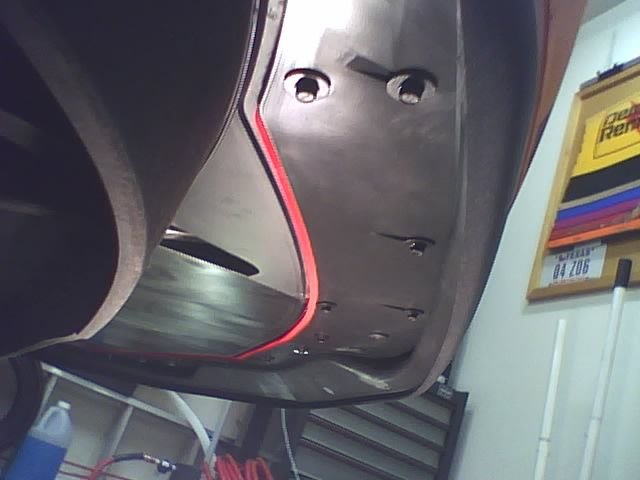

Done! I used factory bolts for now... Just felt too weird drilling into Tiffany. Ha, no pun intended.
Before I take her to the track, I'll install those widget things that push into place. Whatever they're called.
If you are really going to go to the track, you might want to use metal bumper cover screws (with washer and nut) instead of the plastic rivets.
There is a lot of aerodynamic force on the spoilers and splitter at track speed.

Tex just to be sure, are those the same bolts that are already on the bumper? Just get some of those and fasten the same way?
Yes, I used the same GM bumper cover screws and u-nuts. I drilled just a 1\8" hole and used a 1" flat washer and u-nut inside the bumper. (not actually clipped onto anything). I could reach all the screws to attach a u-nut, except the two in the center of the bumper, where I did use a 1/4" plastic push in rivet.
